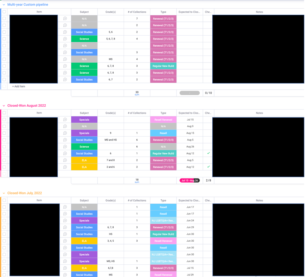

Hi Trudy.   This is a unique use-case that we have never had before.
We are migrating our business side of the company to Jira from our previous product called Monday.   Monday is really a project management app.
This particular team requires the same "structure" as they have in Monday which is the ability to have groups of issues i.e. Active work, Blocked work, Archived July 2022, Archived August 2022, etc.
They also:
  • They need to be able to add new groups as needed.   (each month will get an archive group)
  • They need to be able to move a "grouping" up/down in the view (they may have a new group added that needs to be say second from the top)
  • Have visibility into every issue in a group even if archived (so can't actually start sprints as any closed status issue would disappear)
  • DO NOT work in sprints
  • DO NOT need a board - only a list type view (counts out Kanban)
I thought (hoped) Jira Work Mgmt project would be the solution, but it has a lot of functions that don't work or have enhancement requests in process.   The only thing I found that would give us the grouping they want is Jira Software Scrum project template, and I would have to use sprints in place of the groups.
Hope this helps clarify the use case.   Unfortunately I know i'll have more in the near future as more teams migrate off of Monday.
