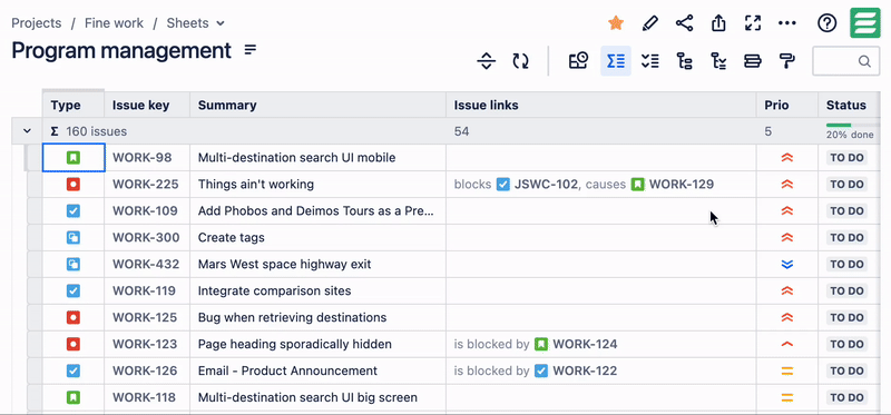

Alternatively, if you're open to solutions from the Atlassian Marketplace, you may want to have a look at the app that my team and I are working on, JXL for Jira.
JXL is a full-fledged spreadsheet/table view for your issues that allows viewing, inline-editing, sorting, and filtering by all your issue fields - including an issue's issue links - much like you’d do in e.g. Excel or Google Sheets. For the issue links column, you can configure the exact format you want to be shown, e.g. with or without the issue link type, with or without the issue summary, etc. etc.
This is how it looks in action:
(Note that JXL can do much more than that: From support for configurable issue hierarchies, to issue grouping by any issue field(s), sum-ups, or conditional formatting.)

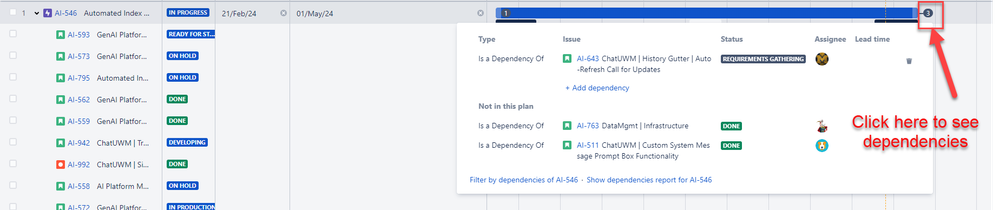

I'm not aware of a way to do this in the filter results, but you could create a Plan and then use the Dependencies Report to see the linked issues that have the specific link types that you care about (you can define these in the Advanced Roadmaps setting).
I think the Dependencies Report only shows the relationship if both issues are in the Plan but, if you build out the gantt chart, you can see dependencies even if the linked issues aren't in the Plan.
