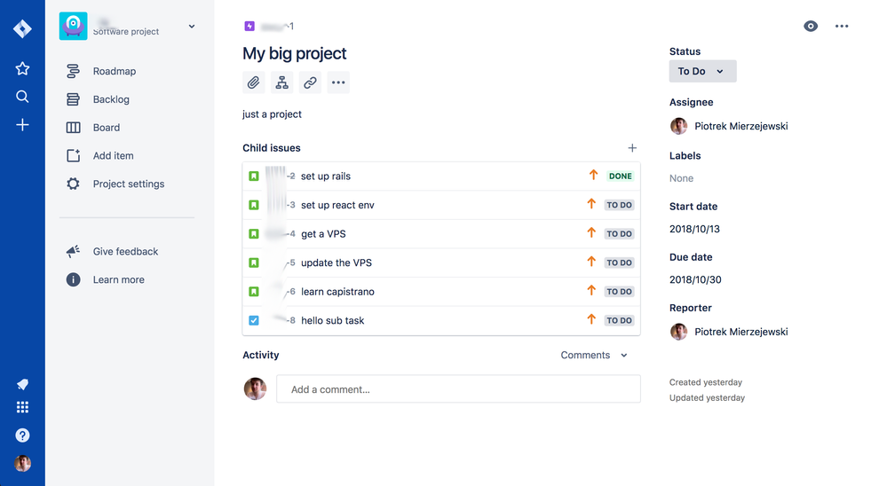

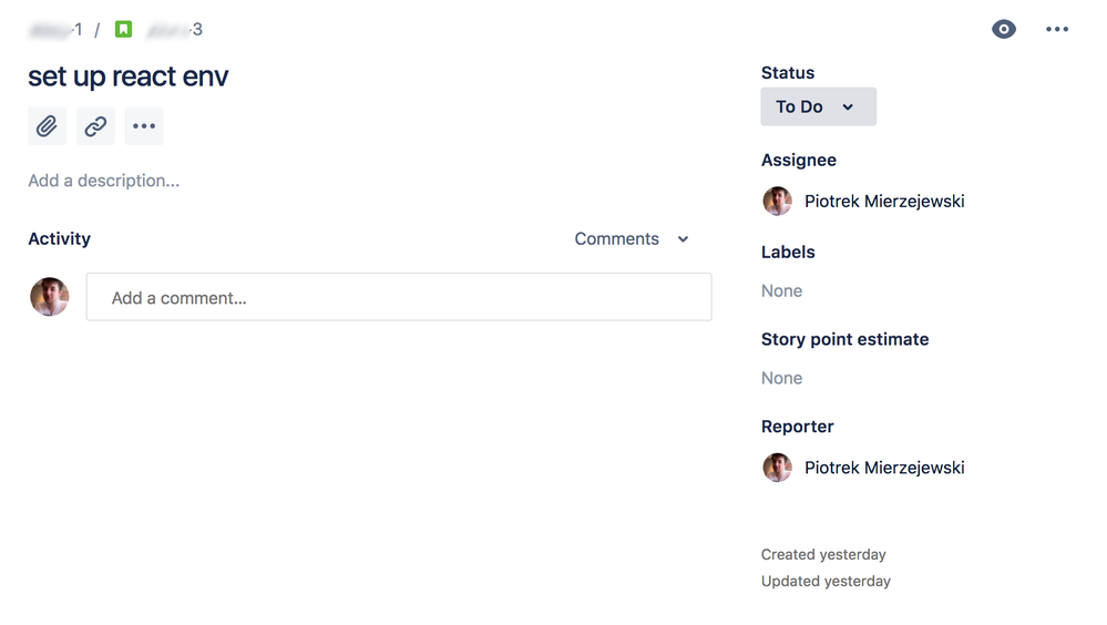

@Andrew Zibuda: I don't think so, here's what it looks like in Jira:
  1. Epic view
  2. Child view
@david: why do you think it's a bug that I see the Epics in board endpoint? Do you think they should be accessible from the API at all? I agree that it's quite inconsistent behaviour though, I suspected it to be a bug too.

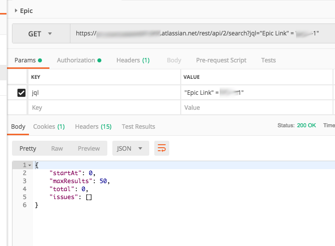

Alright so I don't see any Epic Link field like we have but if you can find some linking field you can do a GET search based on that, this is the way we get all issues in an Epic:
get("/rest/api/2/search")
.queryString("jql", "\"Epic Link\" = \"$epicKey\"")
.asObject(Map)
Piotr Mierzejewski
October 30, 2018
@Andrew Zibuda it doesn't return any results, so I think the Epic Link field isn't used in this case.
