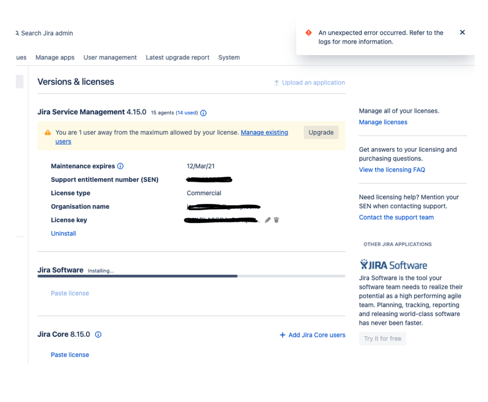

Jira Software Server application is now missing and uninstallable after upgrade to 8.15 from 8.14.  Jira logs complain about GC Allocation Failure.
Any ideas how to get Jira Software installed and working again?

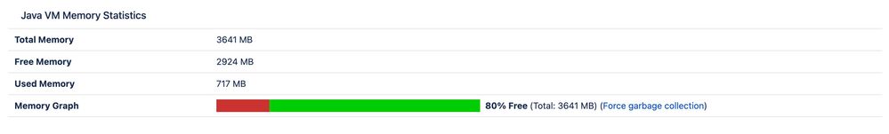

In the past I have seen something similar occur when the server runs out of memory.  Can you share your startup logs so we can see what is occurring.  Here is a KB about GC errors caused by memory and tuning issues.  https://confluence.atlassian.com/jirakb/jira-running-out-of-memory-due-to-gc-allocation-race-condition-957122851.html
Joe Lyons
February 16, 2021
Thanks for reaching out Brant, here is a screenshot of the memory for jira:

Brant Schroeder
February 17, 2021
@Joe Lyons
As stated before it has nothing to do with the GC but out of memory or CPU which has to do with your hosting environment not having enough memory or CPU for everything else running on the server.  What does your hosting environment look like?  What is your OS, memory on the server, and CPU on the server?  Please take a look at the KB I attached if you have not already as it will provide some troubleshooting information.

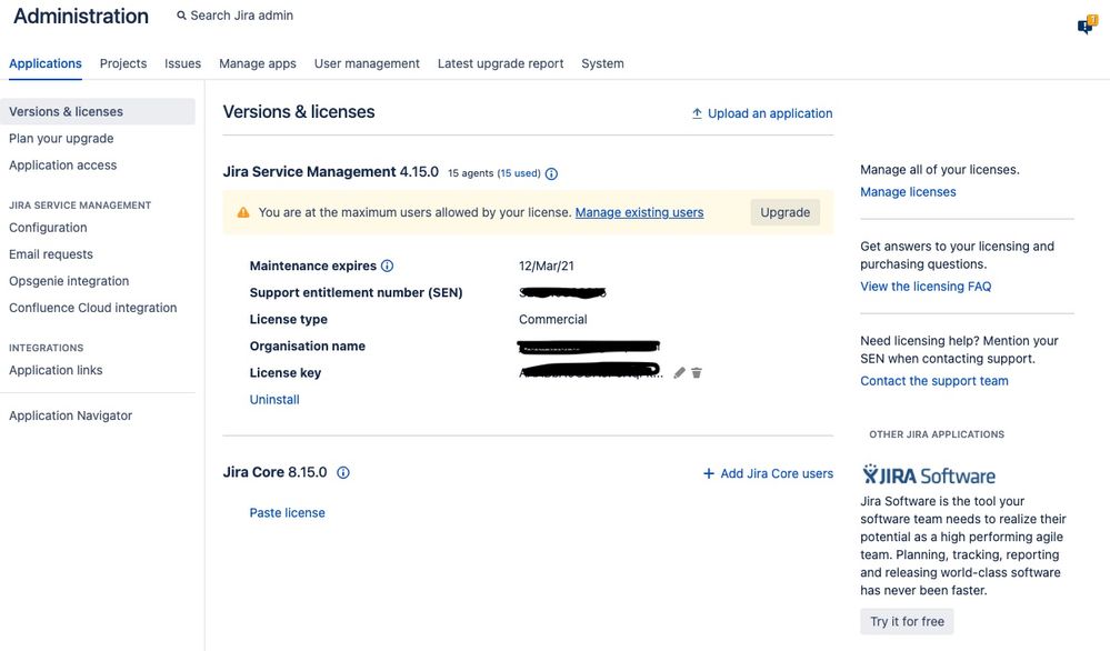

Brant Schroeder
February 17, 2021
What does your application page look like right now?  Can you share a screenshot?
Brant Schroeder
February 17, 2021
Does it just show that the app is not installed?
Joe Lyons
February 17, 2021
Correct, this is what the Versions & Licenses page looks like.  I have tried to click the "Try it for free" button on the bottom right of the screen, hoping that would install the software and I could paste License key in.  However when I attempt to install this way that is when the process fails and the GC errors begin (during this install).

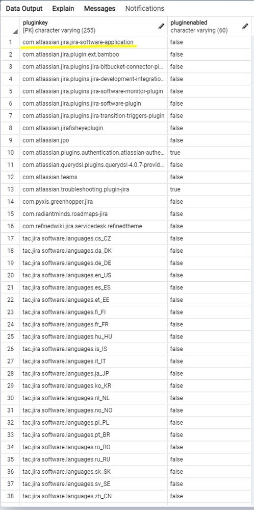

Ok that didn't work as hoped.  So I went into the database and replaced false with true on this entry com.atlassian.jira.jira-software-application in the pluginstate and I was able to get Jira Software back and licensed, although I appear to be missing the actual functionality.
Joe Lyons
February 17, 2021

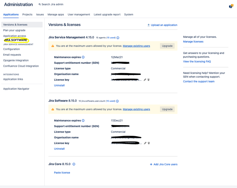

While, I was not able to successfully down and install Jira Software this way, it looks like it just times out with zero feedback.
I went into the database and enabled the plugin for com.atlassian.jira.jira-software-application to true and restarted Jira.
I was able to get the Jira Software back and add a License key, however it does look like I have any of the actual functionality of the app.  As you can see its missing the Jira Software conf menu item on the left.
Brant Schroeder
February 17, 2021
Progress.  Can you look at this - https://confluence.atlassian.com/jirakb/jira-startup-fails-with-message-that-required-plugins-are-not-started-254738702.html
There are most likely additional apps that need to be enabled.
Joe Lyons
February 17, 2021
Funny enough, right before you sent this along I went back into that table and set all plugins to true and that did the trick.
I can't thank you enough for assisting throughout the process.  This is a first, running into problems after an upgrade.  Not sure how the system got in this state to begin with, but certainly very happy to have found a way out of it.
Again, thanks for your help.
