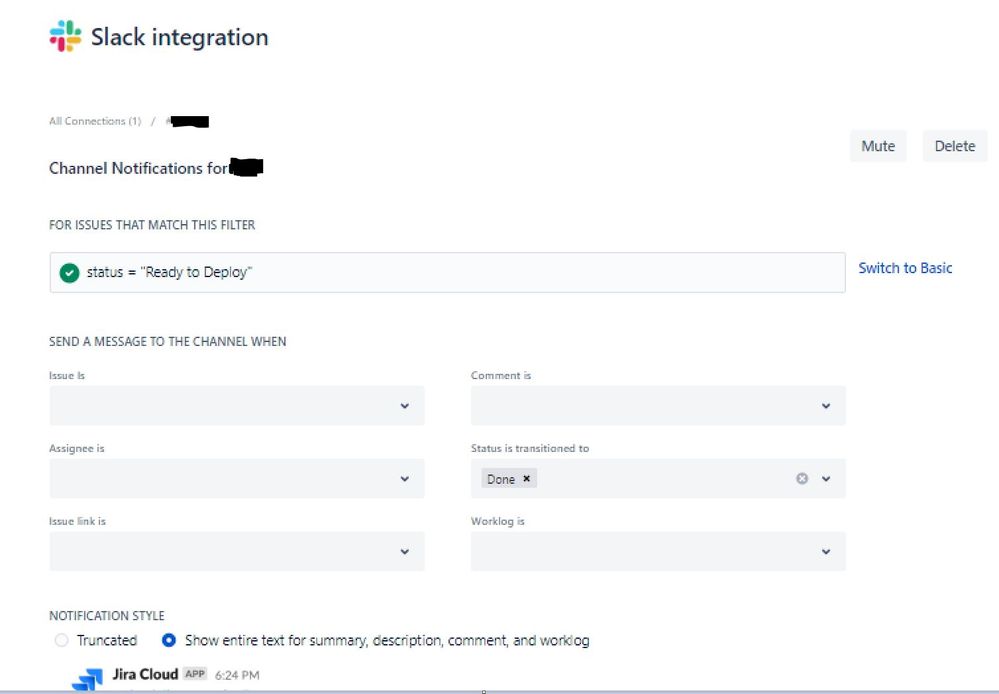

I have a Jira Clound - Slack integration. I would like to see in a specific Slack Channel ONLY the issues that go (transition) from "Ready to Deploy" to "Done".
I currently have the below setup but it is not working! All and every ticket that transition to "Done" even if it was not previously in "Ready to Deploy" is making it to the Slack Channel.
Any idea on how to properly configure this (see in a specific Slack Channel ONLY the issues that go (transition) from "Ready to Deploy" to "Done")?

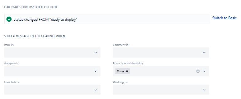

Edgar Sierra
February 3, 2021
That didn't work :(
We updated the JQL, created a ticket and move it through the flow, the ticket did not make it to the Slack Channel...

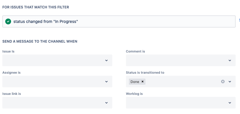

Luiz Silva
February 4, 2021
Hi @Edgar Sierra
The status changed from clause should work but you still have to select Done in Status is transitioned to field.
I was able to replicate such configuration successfully, just with a different status name:
Hope that helps. Cheers!
Edgar Sierra
February 12, 2021
Hi @Luiz Silva ,
That did not work either :(
This is the config we setup yesterday
