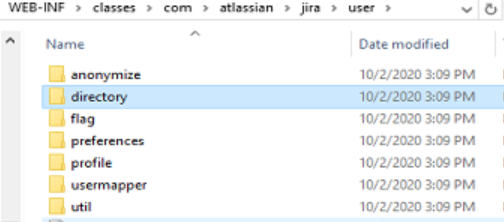

Hi Dirk/Earl, just following up on this case, how can I locate the specific location of the Jira Installation Directory and the Jira Home Directory as mentioned previously? The closest I am able to find is as follows:

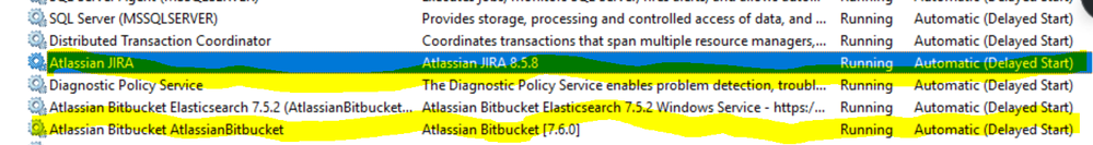

On a side note, I noticed that in one of your screenshots you appear to have a service there for SQL (called MSSQLSERVER). If Jira is using that as the SQL database, then this service will act like a dependency for Jira to be able to startup correctly. Jira requires that when it starts up, that it can have immediate and unfettered access to that SQL database so that it can store/retrieve such data. It appears though that MS SQL service is also set on a delayed automatic start in your screenshot.
This could be the source of your problem here where Jira does not startup correctly upon a system reboot. If SQL is still in the process of starting when Jira starts (ie not in the status of Running yet), it's very likely Jira is failing to start up because it cannot access the SQL database it is configured to use. If this is the database server that Jira is using, try adjusting the MSSQLSERVER service to start up as "Automatic" instead of "Delayed Automatic". That service has to be up and running before Jira can be expected to work. Leaving the Atlassian Jira service setup to be on a delayed automatic start could then allow the Jira Service to start up successfully after a reboot of the operating system.

Hi Andy, that was it; thank you so much for your help and insight!

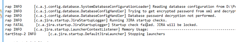

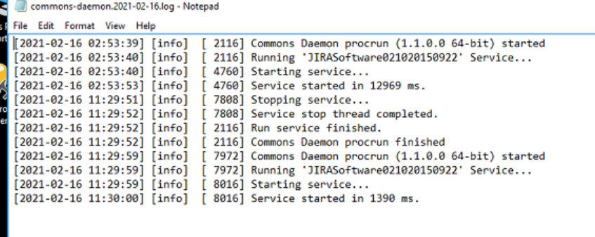

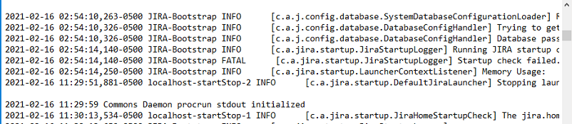

HI Dirk, it looks like per the logs, I was able to find out that the Startup check failed and I believe it locks our Jira Service and then begins to fail to load until we manually restart it again. If you see below in the pics, you can see when we have our servers auto restart at 2:53am it fails but then we manually restarted them at 11:29AM today - any idea on how to fix this approach as to why it locks out?
Well yes and no, it actually locks your JIRA because the startup check failed.
Do you maybe have more details higher in the log file?
I wonder if you restart the server, do you shutdown JIRA cleanly first or just kill the machine dragging JIRA down with it. (So maybe it wasn’t closed cleanly and now fails because of it) If you could get the log from just before the restart up to that error I hope something is in there.

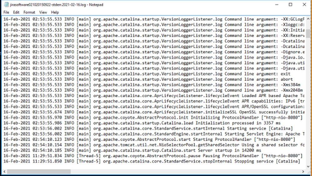

Here is a few more screenshots, I hope they help? How can I open a ticket with Atlassian Engineer?
I believe we just kill the machine dragging Jira with it since we run an automatic task scheduler at a time frame early in the AM.
Hi @ORT JIRA ADMIN ,
The new screenshot only confirm that something is breaking at startup causing the service to abort.
Without full access to the log(s) it's tricky to troubleshoot so I'll have to forward you to Atlassian.
