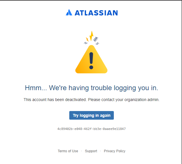

Why is it so hard to re-enable a returning staff member in the Jira Service Desk, so I can create a ticket for the returner but when the returner tried to raise themselves they get an  error saying :  :(

You'll need to come up with a different method of requesting / handling this.  Deactivated users are not to be used, they're deactivated for a reason.  Their accounts can't be used, including in user pickers, so there's no way an existing deactivated user can do anything, or even be picked out by their team-members who have asked them to rejoin.
For you, it's a catch-22 - you can't raise a re-activate request directly yourslef because you can only do it from an active account.
Best I can think of is using an anonymous Jira Service Management project with nothing but "reactivate account" requests, at least the old user would be able to get something into your Jira (then I'd probably automate "create linked issue" into the project where you're agents are actually handling them)
