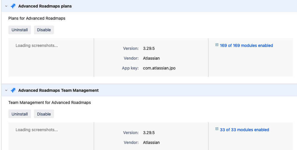

Dear community,
Context:
- Jira Server - v8.13.2 (#813002-sha1:c495a97)
- PSQL Database
We are experiencing some exceptions in the atlassian-jira.log logs with the Portfolio plugin, which seems to have been renamed as "Advanced Roadmaps for Jira".
The exception shown below is referring to a license issue. Our Jira Software licenses are all valid and we have the Advanced Roadmaps plugin installed:
  • What could be the issue here and how to fix it ?
    • Simply uninstalling and reinstalling the plugin ?
    • Won't that cause any compatibility issue with the other plugins ?

June 15, 2021
This is solved.
After uninstalling and reinstalling the plugin, it fixed the issue
