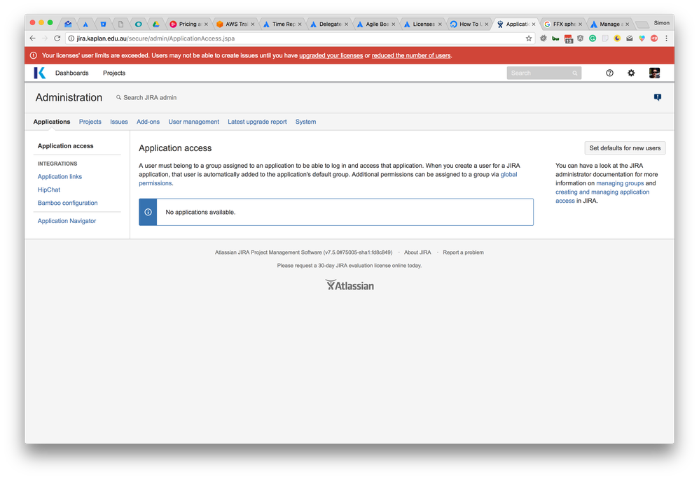

I recently set up Jira Server and imported an export from Cloud.
After the import was completed and running a re-index I am unable to set the default access to jira for the users group.
Screen Shot 2017-10-14 at 2.11.16 pm.pngDoes anyone know how to make Jira show up here? I need to change the user groups to get rid of the notice.
Otherwise everything else seems to be working fine!

Hi Simon,

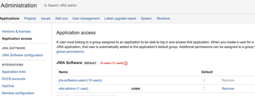

I just went through the steps to import a backup from my Cloud instance to my 7.5.0 server instance and I did not experience this issue after the import:
I would definitely recommend putting in a ticket so the Support team can reproduce the issue with your backup and look at the resulting logs.  In addition, look in the JIRA_HOME/log/atlassian-jira.log for the following:
/secure/admin/XmlRestore.jspa
If you find anything that stands out you can also paste it here and we'll take a look.

Simon Brown
October 14, 2017
Thanks Branden,
I found this error:
JiraImportTaskExecutionThread-1 ERROR user 261x1576x1 1g46ahr 110.150.64.146,10.170.1.145 /secure/admin/XmlRestore.jspa [c.a.j.bc.dataimport.DefaultDataImportService] Error during ActiveObjects restore
com.atlassian.activeobjects.spi.ActiveObjectsImportExportException: There was an error during import/export with plugin JIRA DVCS Connector Plugin(com.atlassian.jira.plugins.jira-bitbucket-connector-plugin) #4.1.10 (table AO_E8B6CC_CHAN$
        at com.atlassian.activeobjects.backup.ImportExportErrorServiceImpl.newImportExportSqlException(ImportExportErrorServiceImpl.java:26)
Simon Brown
October 14, 2017
Thanks again Branden,
Turns out I was just logged in with the wrong user! I thought my user had sys admin rights, but turns out not!
All good now.
