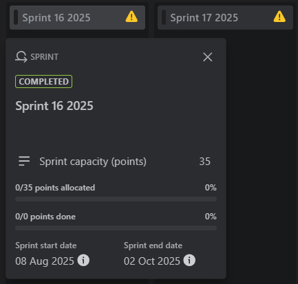

We have a program board setup with various teams and sprints etc. When looking at old sprint, for example Sprint 16, none of the completed tickets are showing under the sprint for that team. They were visible when we planned out the sprints months ago but have seem to disappeared.
Running the sprint report against the configured sprint shows all the completed issues, all with resolved statuses and resolution dates within the sprint dates.
I also tried modifying the sprint completion date in case the resolution dates on the tickets were outside the sprint dates but this has had no impact on the board.
We just use a label on the any issue types we want to see in the board for simplicity so the filter criteria is being met. We can also see completed issues in the last sprint and active issues in the current sprint.
The Sprint end date is set to the 2nd August in the sprint configuration, when looking at the sprint report, all completed tickets are within the start and end dates.
This screenshot shows the sprint end date in October as it uses the Sprint Completion date and not the defined end date.

I figured it out, I had an exclusion rule set to not show completed tickets after 30 days. Changed this to a 4 month period so it shows tickets for the whole quarter.
