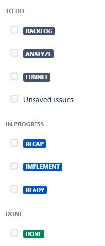

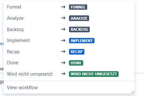

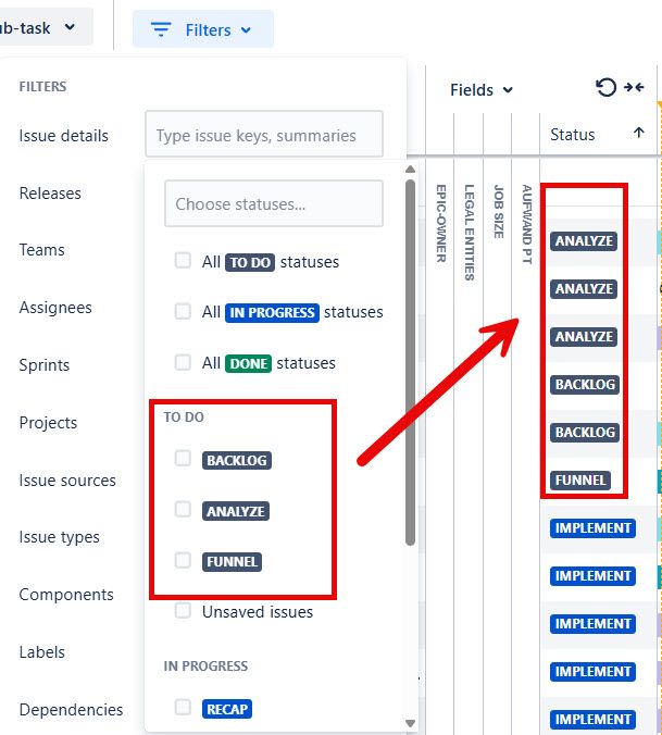

I have the following issue in Jira Plans - instead of the "correct" Workflow order, as given in the opsbar sequence as well as the Jira Adminstration of Status, it shows the following mix-up of Funnel/Analyze/Backlog. I am on Jira DC.
Any help here is highly appreciated as without the correct order, Plans is impossible to use for us, if sorted incorrecly ;)
Jira Plans Sorting:
Workflow Sequence (Opsbar) - as it should be given in Plans, otherwise Plans does not make sense at all...

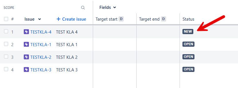

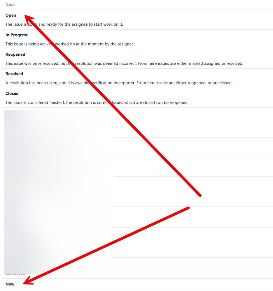

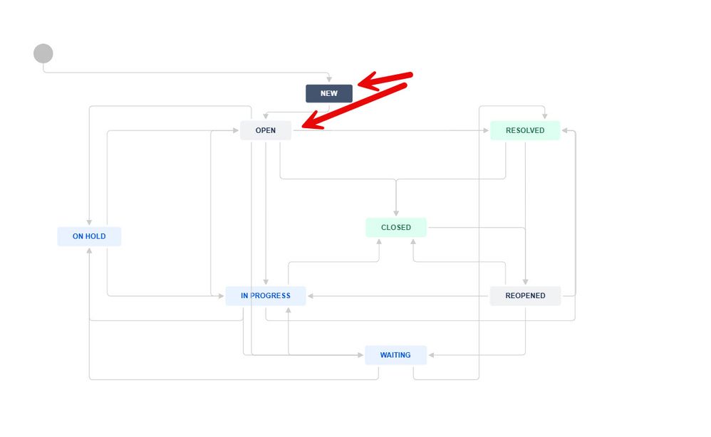

I tested this now: the order is the following in Jira Administration Status Section. Creation date of status "new" later than "open".
And if I then create a plans and sort by status, it shows the Status "new" on top - as it is the first status in the workflow and even though it was created later than the standard status:
--> so it is working according to workflow after all. The creation date of the status does NOT impact then Jira Plans.

Is it actually alphabetically within a category?!? OMG.
https://support.atlassian.com/jira-software-cloud/docs/how-advanced-roadmaps-sorts-issues/
