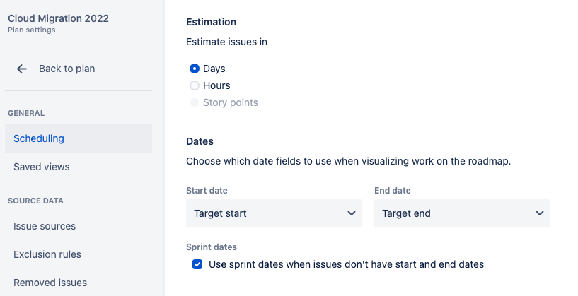

just to confirm, re delivery fields, have you gone to the plans config settings and set the fields you want to use as start and end dates in the plan?
Tom Lister
August 5, 2022

@becciwa have you checked the plan Scheduling settings to ensure that the correct date fields are configured?
Becci Watson
August 7, 2022
yes, the dates have the D on them.
It doesn't work for any of the date fields, irrespective of which ones are chosen.

Hi could you screenshot your schedule config?
Tom Lister
August 8, 2022
I've just seen your comment about the dates having D on the columns i.e. are the schedule dates.
I've tried the same on my plan. If I edit the issue and change the schedule dates, then refresh then it reflects on the bar.
As long as the dates are within the view range. But even then it has an arrow button to shift to that period.
No more ideas :-(
