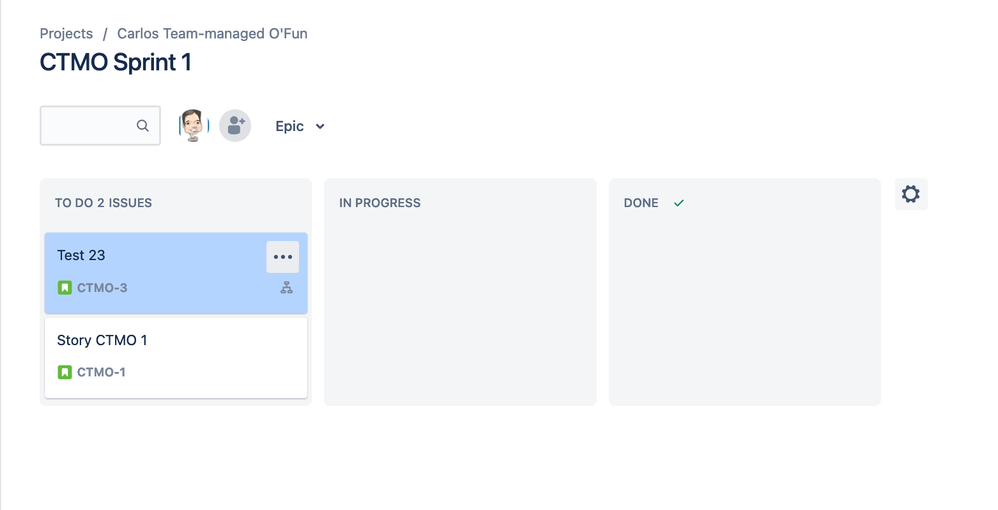

Carlos Garcia Navarro
April 12, 2022
Hi @Dan Churchill ,
I just tried with a team-managed project and I can see stories in the sprint with a story with a sub-task on it. Does your board have any custom filter?

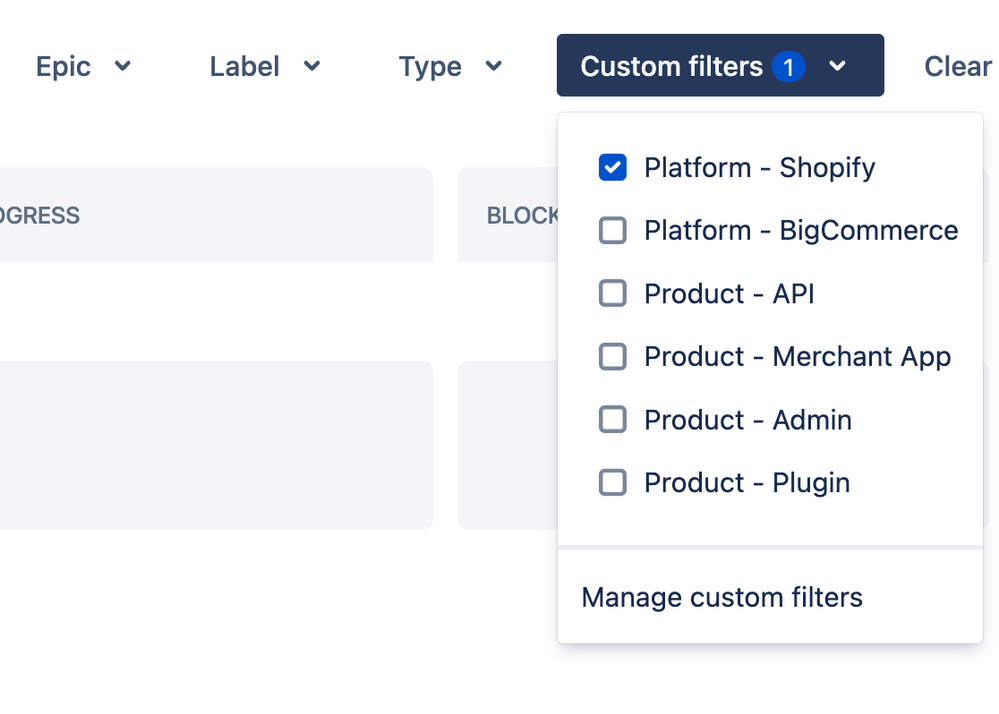

Dan Churchill
April 13, 2022
I think you've mis-understood my issue.
My issue isn't with stories being displayed when they have sub-tasks.
My issue is that when I define a custom filter in next-gen project, then use it on the board as shown in this picture, the ticket that should show up will not show up unless:
1) It has no sub-tasks
2) the sub-tasks match the filter
These stories WILL show up in the BACKLOG view, however.
I've even created a simple custom filter that is literally "ID = PROJECT-123" and that ticket will not display if it has sub-tasksimage.png
