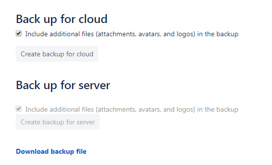

Tarun Sapra
January 21, 2019
Hello @Rangaraj
The error you are facing is because at the time of backup you have to mention that the backup is for server, as I think by default it takes the backup for cloud only.
Rangaraj
January 21, 2019

Rangaraj
January 21, 2019
Hi @Tarun Sapra,
I have selected Back up for Server and download the file.
