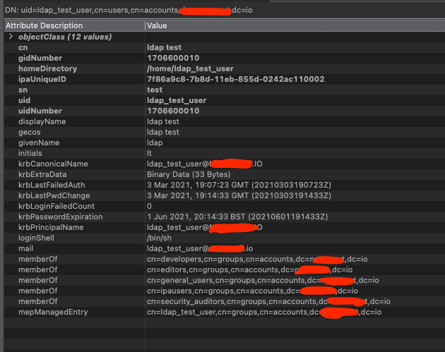

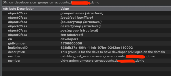

Hi all,
I am working on integrating a Jira instance with a freeIPA instance trough LDAP to retrieve all the users being stored in the freeIPA user directory. I can manage to retrieve all the user, but I cannot seem to be able to retrieve the user groups/memberships, the "Test get user's memberships : Failed" seems to fail all the time with no particular info in the jira-software/logs/atlassian-jira.log file. No luck finding any other resources online, has anybody encountered such issues if so what did you do?
The schema I am using is bellow :
Directory type : LDAP, OpenLDAP (have also attempted to use LDAP with internal authentication, which doesn't give me any groups either)
base DN:cn=users,cn=accounts,dc=example,dc=io
Read Only, with Local groups checked and adding to jira-software -users by default.
Use schema - all user info is being retrieved, so no issue
Group Schema
Group Object Class : groupOfNames
Group Object Filter:(objectclass=groupOfNames)
Group Name attribute: cn
Group Description attribute : description
Membership schema
Group Memebers attribute : Member
User Membership attribute: memberOf
Example of my freeIPA user object and group object bellow:

Kevin Lange
October 21, 2021
I'm pretty certain this requires that the connector is authenticated with Username/password in the Server Settings.
