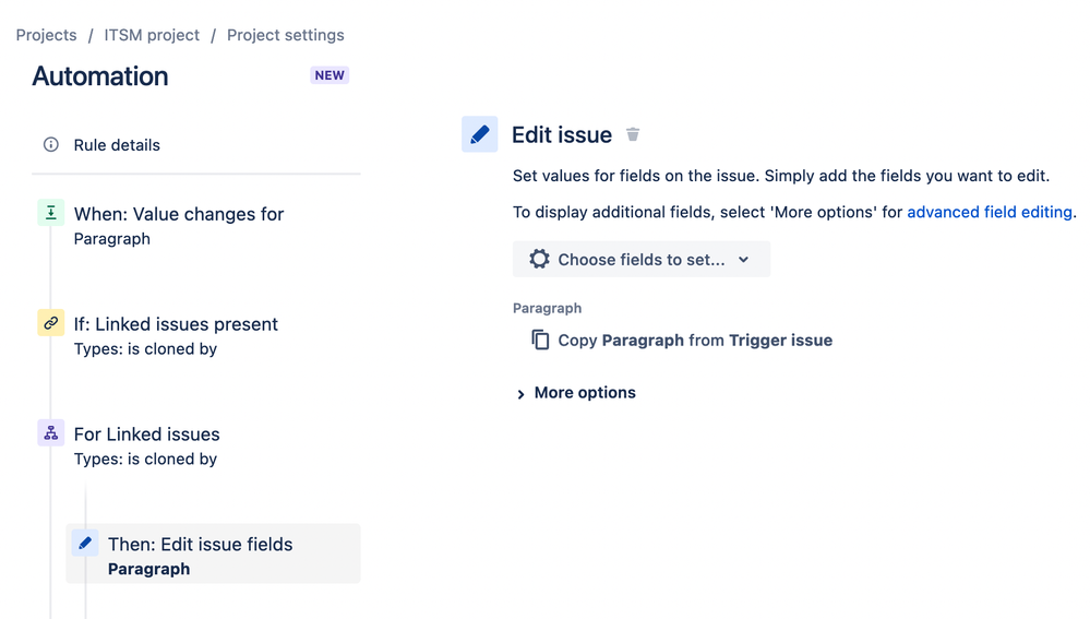

You can follow the example below to understand how this can be achieved - P.S: In the example below, I used the field "Paragraph" as the field you would like to update:
The rule background would be:
  1. Trigger: The rule is triggered when the field "Paragraph" is updated on the cloned issues
  2. IF: Condition to confirm it is one of the cloned issues that got updated (If there are any linked issues with the link type "Is cloned by")
  3. Branch:  Select the personal issue
  4. Action: Update the personal issue, copying the paragraph field from the cloned issue that was updated
Let us know if this information helps.
