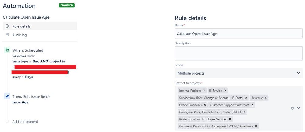

Srilata Meka
October 12, 2020
Hi @Ste Wright , The solution suggested by you had been working great for Project A. Now I am applying this 'Automation Rule' to all the existing projects in our Jira instance.
I updated the Scope of the Automation Rule to Global & ran the Rule. But Rule ran only on Project A.
I tried editing one of the 'Issue' from Project B and ran the rule, 'Issue age' was displayed only for this defect from Project B.
I tried updating the Scope to 'Multiple projects', updated even JQL query and ran the Rule. but still no luck.
Can you please let me know, what am I missing?
Any help would be greatly appreciated. Thank you !

Srilata Meka
October 13, 2020
Hi @Ste Wright , Thank you,  I am all set!
Your initial response had the answer to my yesterday's question. I setup the automation rule at project level & am seeing the expected results.
