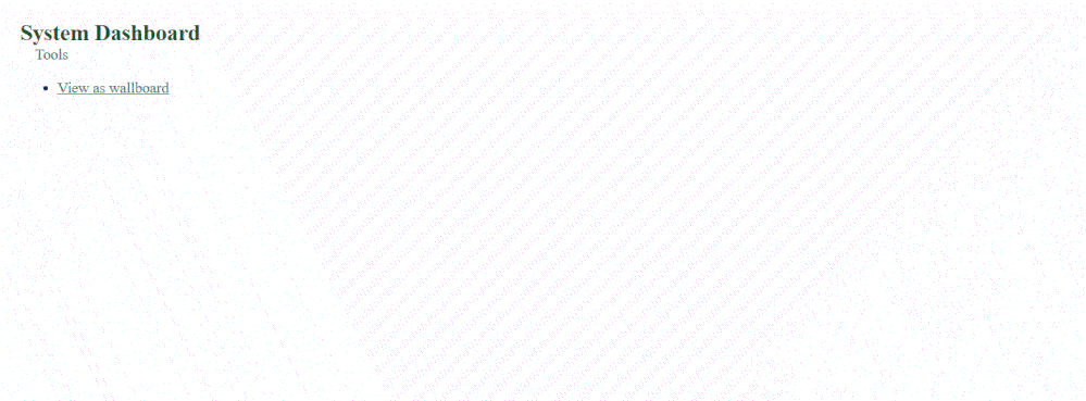

Hi
I enter safe mode and exit without save(I dontchabge any thing! ), but after that anything(dashboards, issue,login ,... ) was not displayed in best way!!
like this pic:

This is is usually caused by the network not being able to serve up part of what the client has asked for from the server, but the underlying cause may be the network being told the wrong thing, rather than the actual network failing.
Start on the client side - clear the browser cache and restart the browser.  Sometimes, cached data can mislead the network requests.  This is especially common after an upgrade, as some of the cached requests may be pointing to the wrong place.
Second thing to to is a simple orderly restart of Jira - in theory, an upgrade should have done it, but sometimes it doesn't clear the server side cache properly.  Using "stop jira.sh", waiting a minute until it fully stops clean and then "start jira.sh" gives you a clean cache which can then tell the network the right things.
If it continues after those two tests, then you'll need to start looking at developer tools in the browser - you want to look for what the browser is requesting and what the network is responding with - it should tell you something about "failed to get file .js or y.css" to help you start tracking

Hi @Nic Brough -Adaptavist-
I did all things you said, but  the situation is the same.
I read atlassian.log and send this:

2021-08-15 10:00:47,808 http-nio-80-exec-17 WARN anonymous 600x29x1 1nq7uei 172.30.22.111
/ [c.atlassian.ozymandias.SafePluginPointAccess] Unable to run plugin code because of
'java.lang.RuntimeException - com.google.template.soy.tofu.SoyTofuException:
Attempting to render undefined template 'aui.dropdown2.dropdown2'.'.

OK, there is something badly wrong in your installation if it's missing templates.  That error on the end is likely to be only one of many though, are there more?
