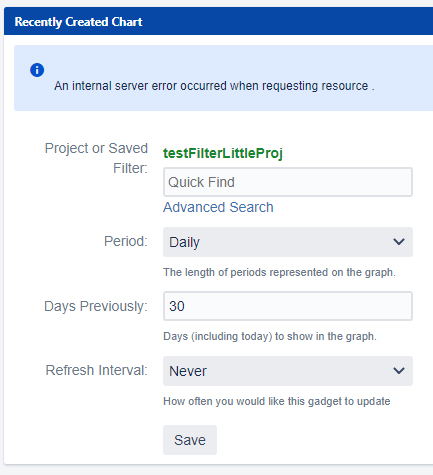

Hello,
I have following error. When I try to add the 'Recently Created Chart' gadget to the dashboard, I receive the 'An internal server error occurred when requesting resource.' error message. The atlassian-jira.log prints following error (I masked the IP with 00.000.000.000).
Additional information:
  • I have already tried to reindex the whole instance, but nothing changes.
  • Some other gadgets doesn't work neither (e.g. Workload Pi Chart).
  • Others work (Bubble Chart), so it's not a problem with gadgets or charts in general.
  • The filter is ok (it only points to a project) and I have tried several other filters and projects, too.
  • The gadgets are locale ones.
  • The system health check is completely green
  • It's a clients system, so I can't easily reboot Jira
2020-09-11 10:35:25,604 http-nio-127.0.0.1-8080-exec-20501 ERROR admin 635x3985282x109 16d0xch 00.000.000.000,127.0.0.1 /rest/gadget/1.0/recentlyCreated/generate [c.a.p.r.c.error.jersey.ThrowableExceptionMapper] Uncaught exception thrown by REST service: java.io.IOException: Stream closedjava.lang.InternalErrorjava.io.IOException: Stream closed    at sun.util.locale.provider.BreakIteratorProviderImpl.getBreakInstance(BreakIteratorProviderImpl.java:178)    at sun.util.locale.provider.BreakIteratorProviderImpl.getLineInstance(BreakIteratorProviderImpl.java:106)    at java.text.BreakIterator.createBreakInstance(BreakIterator.java:571)    at java.text.BreakIterator.createBreakInstance(BreakIterator.java:553)    at java.text.BreakIterator.getBreakInstance(BreakIterator.java:544)    at java.text.BreakIterator.getLineInstance(BreakIterator.java:483)    at java.text.BreakIterator.getLineInstance(BreakIterator.java:470)    at org.jfree.text.TextUtilities.createTextBlock(TextUtilities.java:220)    at org.jfree.chart.axis.CategoryAxis.createLabel(CategoryAxis.java:1247)    at org.jfree.chart.axis.CategoryAxis.refreshTicks(CategoryAxis.java:1144)    at org.jfree.chart.axis.CategoryAxis.reserveSpace(CategoryAxis.java:861)    at org.jfree.chart.plot.CategoryPlot.calculateDomainAxisSpace(CategoryPlot.java:3399)    at org.jfree.chart.plot.CategoryPlot.calculateAxisSpace(CategoryPlot.java:3466)    at org.jfree.chart.plot.CategoryPlot.draw(CategoryPlot.java:3510)    at org.jfree.chart.JFreeChart.draw(JFreeChart.java:1235)    at org.jfree.chart.JFreeChart.createBufferedImage(JFreeChart.java:1409)    at org.jfree.chart.JFreeChart.createBufferedImage(JFreeChart.java:1389)    at com.atlassian.jira.charts.jfreechart.ChartHelper.createChartImageInline(ChartHelper.java:117)    at com.atlassian.jira.charts.jfreechart.ChartHelper.generateInline(ChartHelper.java:84)    at com.atlassian.jira.charts.RecentlyCreatedChart.generateChartInternal(RecentlyCreatedChart.java:159)    at com.atlassian.jira.charts.RecentlyCreatedChart.generateInlineChart(RecentlyCreatedChart.java:80)    at com.atlassian.jira.charts.DefaultChartFactory.generateRecentlyCreated(DefaultChartFactory.java:99)    ... 2 filtered    at java.lang.reflect.Method.invoke(Method.java:498)    at com.atlassian.plugin.util.ContextClassLoaderSettingInvocationHandler.invoke(ContextClassLoaderSettingInvocationHandler.java:26)    at com.sun.proxy.$Proxy29.generateRecentlyCreated(Unknown Source)    ... 2 filtered    at java.lang.reflect.Method.invoke(Method.java:498)    at org.springframework.aop.support.AopUtils.invokeJoinpointUsingReflection(AopUtils.java:343)    at org.eclipse.gemini.blueprint.service.importer.support.internal.aop.ServiceInvoker.doInvoke(ServiceInvoker.java:56)    at org.eclipse.gemini.blueprint.service.importer.support.internal.aop.ServiceInvoker.invoke(ServiceInvoker.java:60)    at org.springframework.aop.framework.ReflectiveMethodInvocation.proceed(ReflectiveMethodInvocation.java:185)    at org.springframework.aop.support.DelegatingIntroductionInterceptor.doProceed(DelegatingIntroductionInterceptor.java:136)    at org.springframework.aop.support.DelegatingIntroductionInterceptor.invoke(DelegatingIntroductionInterceptor.java:124)    at org.springframework.aop.framework.ReflectiveMethodInvocation.proceed(ReflectiveMethodInvocation.java:185)    at org.eclipse.gemini.blueprint.service.util.internal.aop.ServiceTCCLInterceptor.invokeUnprivileged(ServiceTCCLInterceptor.java:70)    at org.eclipse.gemini.blueprint.service.util.internal.aop.ServiceTCCLInterceptor.invoke(ServiceTCCLInterceptor.java:53)    at org.springframework.aop.framework.ReflectiveMethodInvocation.proceed(ReflectiveMethodInvocation.java:185)    at org.eclipse.gemini.blueprint.service.importer.support.LocalBundleContextAdvice.invoke(LocalBundleContextAdvice.java:57)    at org.springframework.aop.framework.ReflectiveMethodInvocation.proceed(ReflectiveMethodInvocation.java:185)    at org.springframework.aop.support.DelegatingIntroductionInterceptor.doProceed(DelegatingIntroductionInterceptor.java:136)    at org.springframework.aop.support.DelegatingIntroductionInterceptor.invoke(DelegatingIntroductionInterceptor.java:124)    at org.springframework.aop.framework.ReflectiveMethodInvocation.proceed(ReflectiveMethodInvocation.java:185)    at org.springframework.aop.framework.JdkDynamicAopProxy.invoke(JdkDynamicAopProxy.java:212)    at com.sun.proxy.$Proxy3140.generateRecentlyCreated(Unknown Source)    at com.atlassian.jira.gadgets.system.RecentlyCreatedChartResource.generateChart(RecentlyCreatedChartResource.java:120)    ... 2 filtered    at java.lang.reflect.Method.invoke(Method.java:498)    ... 19 filtered    at com.atlassian.plugins.rest.module.RestDelegatingServletFilter$JerseyOsgiServletContainer.doFilter(RestDelegatingServletFilter.java:159)    ... 1 filtered    at com.atlassian.plugins.rest.module.RestDelegatingServletFilter.doFilter(RestDelegatingServletFilter.java:69)    ... 36 filtered    at com.atlassian.jira.plugin.mobile.web.filter.MobileAppRequestFilter.doFilter(MobileAppRequestFilter.java:37)    ... 4 filtered    at com.atlassian.jira.plugin.mobile.login.MobileLoginSuccessFilter.doFilter(MobileLoginSuccessFilter.java:54)    ... 3 filtered    at com.atlassian.diagnostics.internal.platform.monitor.http.HttpRequestMonitoringFilter.doFilter(HttpRequestMonitoringFilter.java:55)    ... 8 filtered    at com.atlassian.web.servlet.plugin.request.RedirectInterceptingFilter.doFilter(RedirectInterceptingFilter.java:21)    ... 61 filtered    at com.atlassian.jira.security.JiraSecurityFilter.lambda$doFilter$0(JiraSecurityFilter.java:66)    ... 1 filtered    at com.atlassian.jira.security.JiraSecurityFilter.doFilter(JiraSecurityFilter.java:64)    ... 16 filtered    at com.atlassian.plugins.rest.module.servlet.RestSeraphFilter.doFilter(RestSeraphFilter.java:37)    ... 19 filtered    at com.atlassian.jira.servermetrics.CorrelationIdPopulatorFilter.doFilter(CorrelationIdPopulatorFilter.java:30)    ... 10 filtered    at com.atlassian.web.servlet.plugin.request.RedirectInterceptingFilter.doFilter(RedirectInterceptingFilter.java:21)    ... 4 filtered    at com.atlassian.web.servlet.plugin.LocationCleanerFilter.doFilter(LocationCleanerFilter.java:36)    ... 7 filtered    at net.bull.javamelody.MonitoringFilter.doFilter(MonitoringFilter.java:239)    at net.bull.javamelody.MonitoringFilter.doFilter(MonitoringFilter.java:215)    at net.bull.javamelody.PluginMonitoringFilter.doFilter(PluginMonitoringFilter.java:88)    at net.bull.javamelody.JiraMonitoringFilter.doFilter(JiraMonitoringFilter.java:137)    ... 22 filtered    at com.atlassian.jira.servermetrics.MetricsCollectorFilter.doFilter(MetricsCollectorFilter.java:25)    ... 25 filtered    at java.util.concurrent.ThreadPoolExecutor.runWorker(ThreadPoolExecutor.java:1149)    at java.util.concurrent.ThreadPoolExecutor$Worker.run(ThreadPoolExecutor.java:624)    at org.apache.tomcat.util.threads.TaskThread$WrappingRunnable.run(TaskThread.java:61)    at java.lang.Thread.run(Thread.java:748)Caused by: java.io.IOException: Stream closed    at java.io.BufferedInputStream.getInIfOpen(BufferedInputStream.java:159)    at java.io.BufferedInputStream.fill(BufferedInputStream.java:246)    at java.io.BufferedInputStream.read1(BufferedInputStream.java:286)    at java.io.BufferedInputStream.read(BufferedInputStream.java:345)    at java.io.FilterInputStream.read(FilterInputStream.java:107)    at sun.util.locale.provider.RuleBasedBreakIterator.readTables(RuleBasedBreakIterator.java:375)    at sun.util.locale.provider.RuleBasedBreakIterator.<init>(RuleBasedBreakIterator.java:321)    at sun.util.locale.provider.BreakIteratorProviderImpl.getBreakInstance(BreakIteratorProviderImpl.java:169)    ... 307 more
