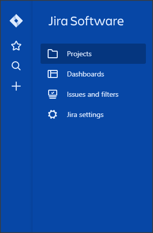

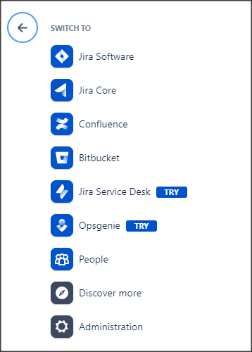

Hi, this answer doesn't really help me at all. The website says Jira Core is for project management, while Jira Software is for software development project management. So I signed up for both, but when I click the application switcher (pic 1) and click Jira Core, it just keeps taking me back to Jira Software (pic 2). As you can see (pic 3), my account has access to both.
What is the purpose of paying another $10 for Core and how do I even get to it? This process could not be more confusing!

The reason "click the application switcher and click Jira Core, it just keeps taking me back to Jira Software" is that you have added Software to Core, and you're going to the system.  It is the same Jira service.
You do not need your Core licences if you just want to use Software.  The Software licences include access to Core, because Software is extra functions on top of Core and can't work without it.  The use-case for having Core licences and Software licences is for systems with more than 10 users and people are using it for different things - imagine for example you have a team of developers using all the Software functions and an admin team who only need task tracking without boards, sprints and velocity etc.  It's cheaper to licence 200 developers and 50 admins than have to get 250 developers

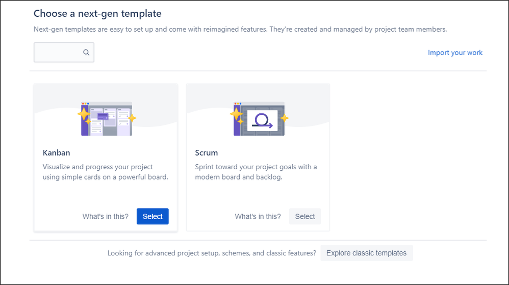

Thanks again, Nic. This all sounds well and good at a high level, but I'm still unclear what each piece actually looks like in practice (I am the admin).
So if I click New Project, I get 2 options - Classic Project or Next-Gen Project. For each, I get a choice of a default template, or to Change Template. If I choose Classic, then Change Template, I get a choice of 14 different templates. If I choose Next-Gen, I get only Kanban or Scrum as choices. "Classic" makes it sounds like it's going away at some point, and that is the old way of doing things.
So to put it another way, which of these templates would appear if I was only on Core, both for Classic and Next-Gen?

You are offered "next gen" because you have Software.  "Classic" does indeed imply project types will be going away, replaced by "next gen", but this is quite a long way off at the moment, and only applies to the classic Scrum and Kanban at the moment (I'd expect the offer of "classic" to vanish, and scrum/kanban next-gen replace the two scrum/kanban you see in the list there).  The non scrum/kanban types are from Core.

Still confused.  If next-gen is only for Scrum and Kanban, then that means my Core users would only be able to create things under Classic?
So for non-software development related projects (Core), which templates should I advise my users to use?  Only the "Classic" templates such as Project Management, which don't have any next-gen counterparts yet?

Both Core and Software users can use (create issues for example) in any project, assuming the right permissions.
Core users will not be able to use the boards that the Classic Scrum and Kanban projects come with, and nor will they be able to use Next-gen projects properly (as those are more heavily board driven)
Even if you only have licences for Software, you will still be able to create and use "Business" project types, which are all the types of project you see under "classic" except Kanban and Scrum (but as you've got Software licences, you'll still see those two on the create list too, until Atlassian replace them fully with their Next-gen counterparts)

So if I only had a Core license, I would see all the same project templates here EXCEPT Kanban and Scrum?
Nic Brough -Adaptavist-
September 18, 2019
Yes.  Spot on.
