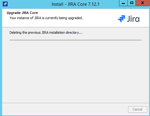

I'm running the 'atlassian-jira-core-7.12.1-x64.exe' to upgrade our Jira installation to 7.12.1. But every time I run it, it gets stuck on the step that says 'Deleting the previous JIRA installation directory...'

I'm forced to cancel and exit the installer, meaning our Jira service is broken.
Is there a log somewhere that specifies what directory/directories it's attempting to delete, what the problem is, and why it's just hung?
ETA: When I attempt to cancel the install, after confirming "yes, I really want to cancel", the install program then hangs and I'm forced to kill the task in order to cancel the install

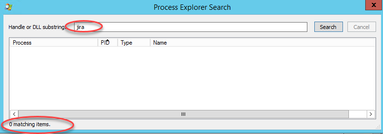

It sound like something is still accessing the JIRA instance.  Check that no applications are accessing those files during the upgrade process. In Windows, this can be done with the Process Explorer using Find and searching for jira.  Once everything is stopped the upgrade process will be able to complete.  Some additional information can be found here: https://confluence.atlassian.com/jirakb/upgrade-of-jira-fails-due-to-error-while-attempting-to-remove-the-previous-installation-directory-313463494.html

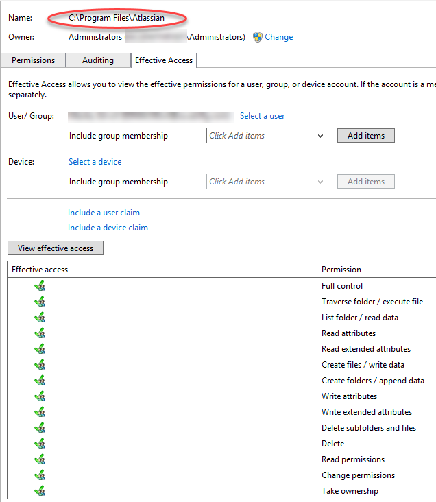

Cause 1. I verified that my ID (which FYI is an administrator) had permissions to "C:\Program Files\Atlassian" (I believe this is the folder it's trying to delete, or a subfolder under it...)

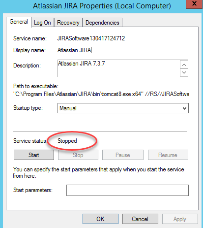

Cause 2. I verified the JIRA service is stopped. Although the link doesn't mention it, I verified the PostgreSQL service is stopped as well.
Cause 3. I made sure via Process Explorer that nothing had a lock on anything named JIRA.

It's actually running under Apache Tomcat. The second screen shot ("Cause 2") is that Apache Tomcat service, which shows that it's been turned off.
