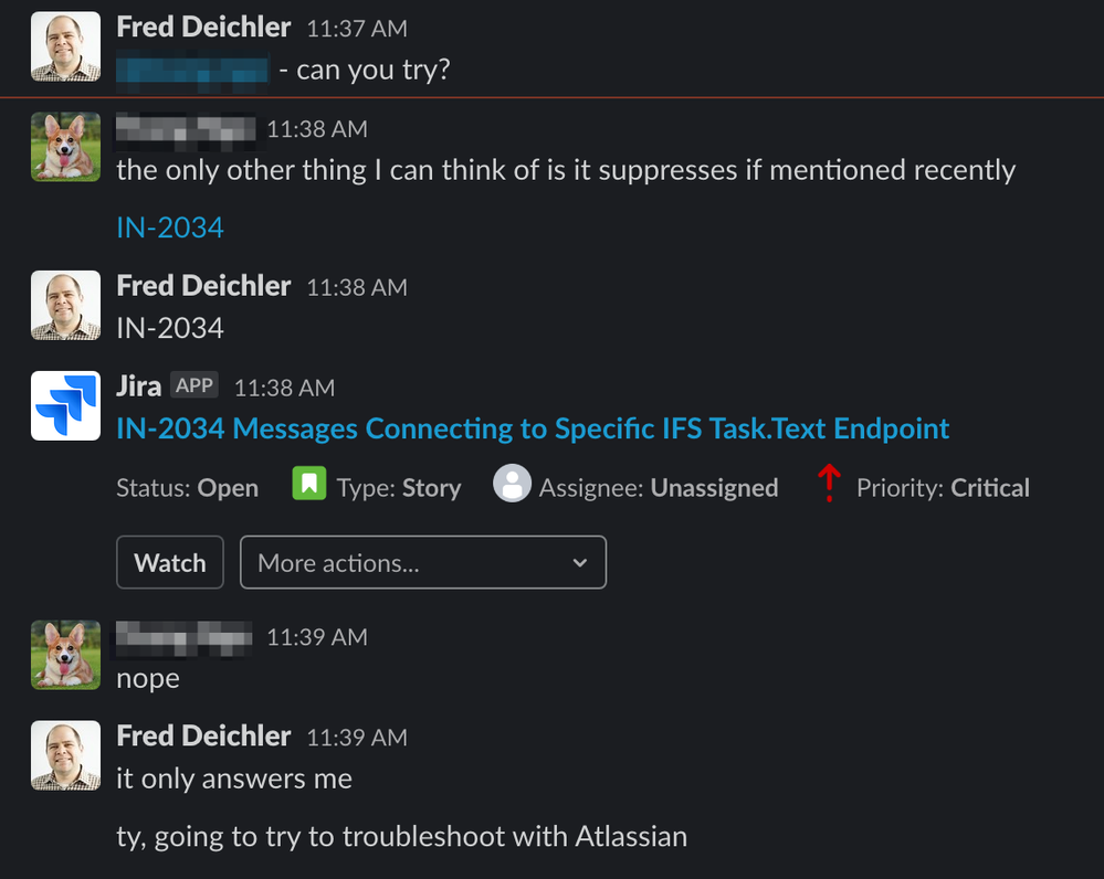

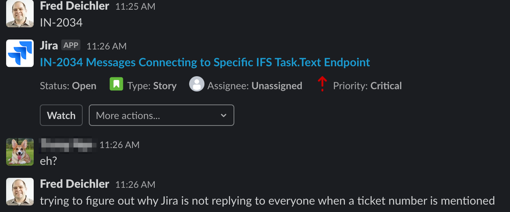

I'm trying to track down an issue where the Jira Cloud app for Slack is not responding to every user.
A user mentioned a ticket and no reply:
I then went and did the same thing and Jira Cloud responded to me:
I had another user try and same thing:

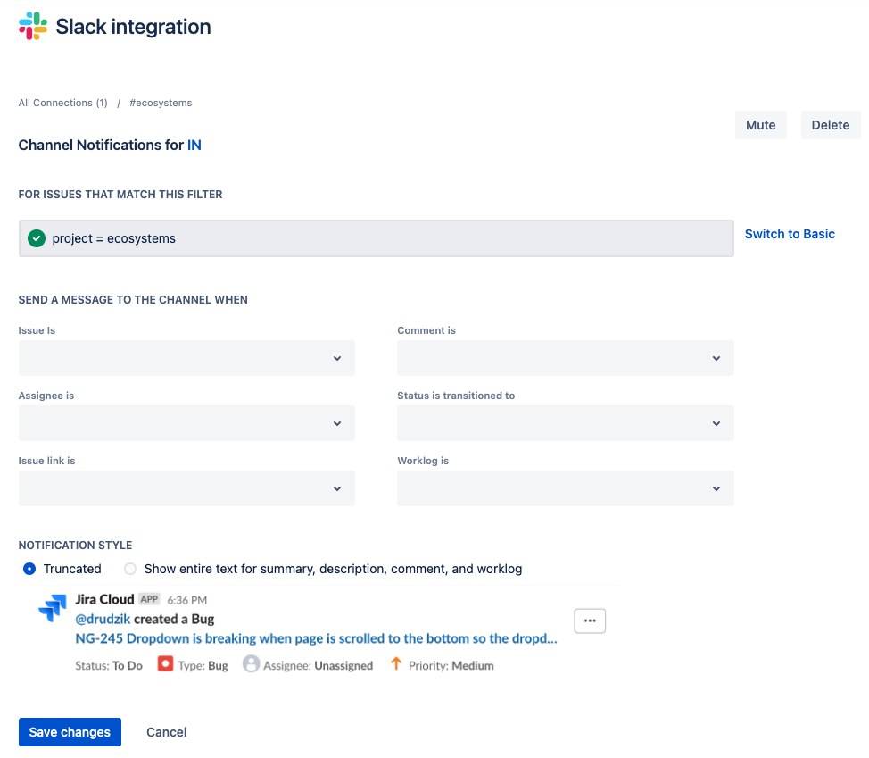

Here is our Slack integration page in Jira for that project:
And, here is an example from another channel/project where I was not involved and it shows the Jira Cloud app not responding to every person:

Hi @Fred Deichler ,

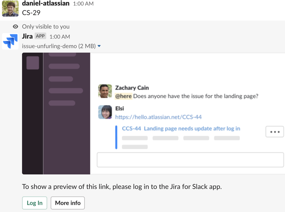

It's possible these folks aren't logged in to Jira through Slack. When this is the case, the app will try to send them a message in the channel:

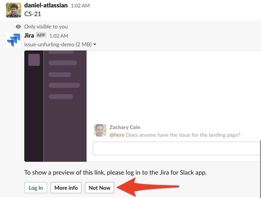

But if they take no action or don't log in successfully, they'll see a button to silence the app the next time this happens:
The app will also wait longer and longer between prompts to log in. It's possible they've dismissed the notification and/or are in a wait period and aren't seeing this ephemeral (visible only to them) message when they mention an issue key.

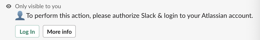

You can have them run the /jira manage command in Slack, which should either tell them they are logged in as a specific Jira user, or give them the smaller message that allows them to log in:

Fred Deichler
March 9, 2021
@Daniel Eads
This exactly fixed it, thank you so much
