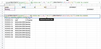

Also, I was playing around with this query a bit more as it was bugging me that CONCAT() only allowed passing 2 options where CONCATENATE() would allow for as many as you wanted to pass in, but the TEXT() variable would not come through when passing into the CONCATENATE() formula.
As TEXT() would not work in CONCATENATE(), what I was able to come up with is to set up a Year, Month, Day, & "\" value in independent fields that can be used for the cell referance pass through to the date to the JQL statement I also added in a Project and Status field as well to make the full JQL editable from the field referance values
Side Note: For the references to project and status I'm also thinking you could get even more elaborate and use drop downs with preset values in these fields to make it look nicer as well and have quick toggle options rather than editing the filter directly but I did not make it that far
Then nested a second CONCATENATE() in the first to combine the variables, and it works really well.
See the following screenshot as an EXE:
The Query I set up has the referance Cells set up as follows:
  • a1 = Project name
  • a2 = Status name
  • b1 = Year
  • c1 = Month
  • e1 = Day
  • d1 = /
And the Query:
=jira(CONCATENATE("project=",A1, " AND status was ", A2, " on (""",CONCATENATE(B1,E1,C1,E1,D1),""") order by created DESC"),"issuekey,summary,status",0,10)
And you could just as easily set up the field's as a variable to pass in as well and do a coma separated list of fields names for your column values in a single field.
