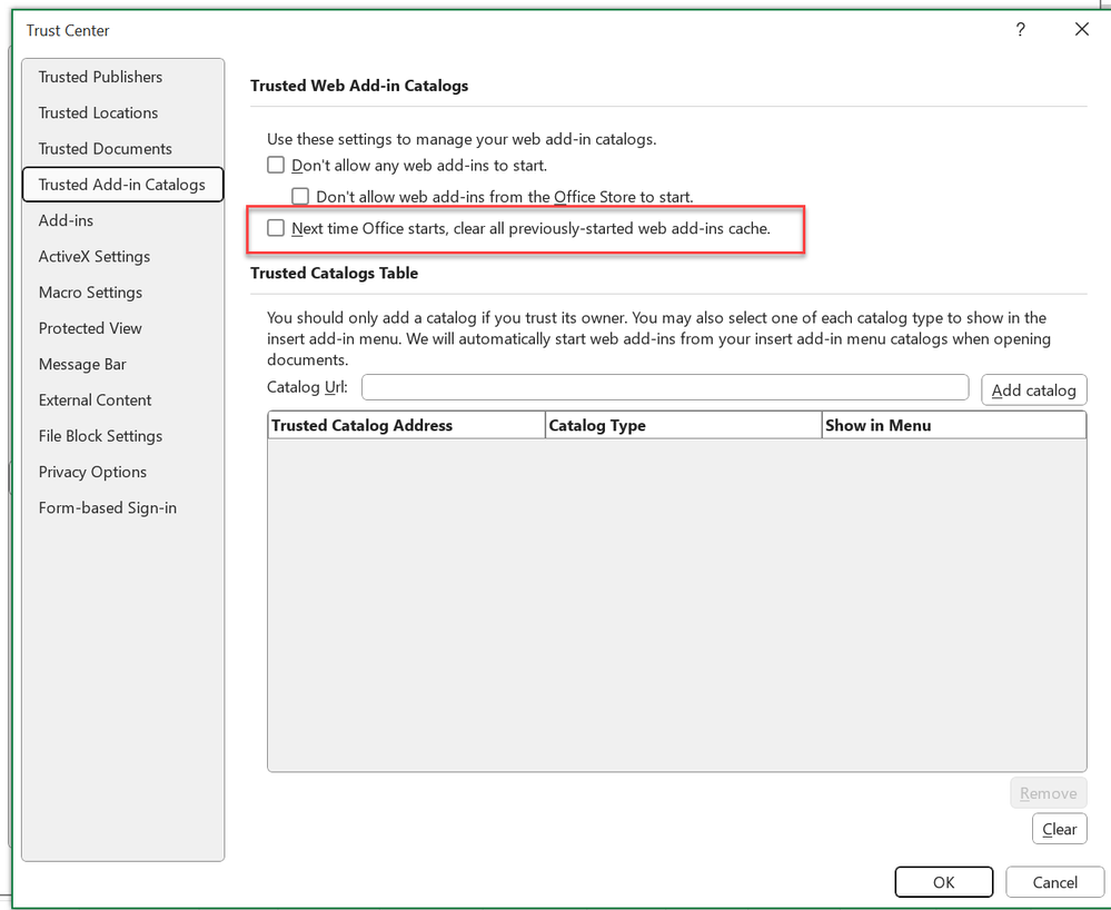

For Desktop excel, what worked for me in the pass was the following:
File -> Options -> Trust Center -> Trust Center Settings -> Trusted Add-ins Catalogs and mark the following option:
Then then close Excel and open the file again.
The above worked for me most of the time, BUT after a while it doesn't remediate the issue, so it is a temporary workaround, I am sharing it here in case it helps.
