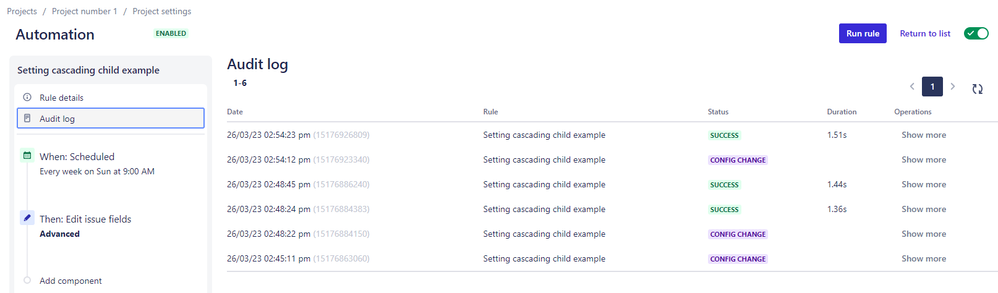

I think your JSON is not working properly, I made a test with automation and the Advanced editing option, which uses a Json, and I managed to update the value of the cascading field.
Here is the JSON I  used: the options values and worked:
"fields": {
"Cascading field" : { "value": "Parent 1", "child": { "value" : "Child 1 - 2"} }

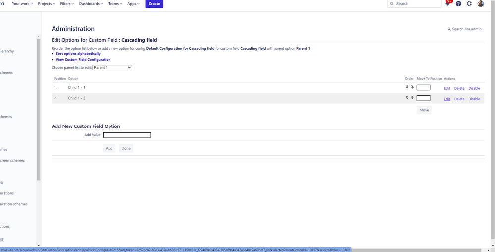

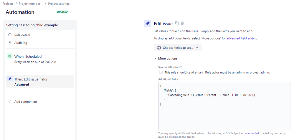

I also used ID of the child option and worked:
"fields": {
"Cascading field" : { "value": "Parent 1", "child": { "id" : "10160"} }
In the last image, note that I got the value from the child issue from the URL: https://xyz.atlassian.net/secure/admin/EditCustomFieldOptions!edit.jspa?fieldConfigId=10215&atl_token=0252bc82-60e3-437a-b636-f571e158a51c_f294694fe493a2305a69c4a347a3e4019a69def7_lin&selectedParentOptionId=10157&selectedValue=10160

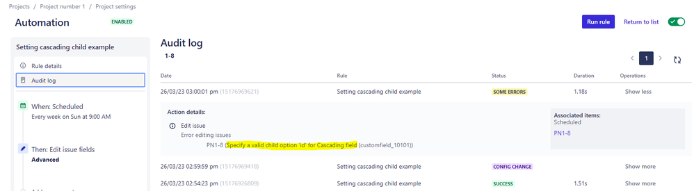

If I test with a wrong ID, like 101600, it would give the error you are getting:
Can you check the IDs you are using and also the JSON you are using with the one that worked for me?
