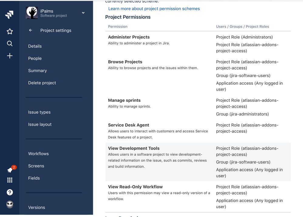

You may not have permission to transition. Can you open an issue into the full issue view and then see if you can transition the status?
I have no rules in place for the project and I am the Administrator.
Can you share a screen shot of your permissions? Primarily the create, browse, etc. example of one of my projects:
Next-gen boards have flat permissions. You are either an Admin or a Member. I am the admin. This fucntionality worked until yesterday and all 3 of my projects are affected.
