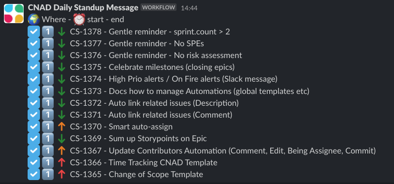

🎯 My Goal
My team is sharing their planned issues for the day in a Slack channel. Up until last week folks did this manually, but as you can imagine this took some time for everyone. Now my ultimate goal was that folks can simply select all the issues in the board they intend to do today with (CMD + Click) and then hit the Automation to send the message for the team. But since the automation sees every issue as an independent event and triggers the automation times the amount of issues selected its not really working. It would send an independent message for each issue selected. Still having a manual multi select counting as one event would be a perfect fit for my use case, but I found a ...
🛠 Workaround
Now what I did to solve it is quite simple, but not as good as the above described ultimate goal. I just added an automation with a manual trigger to then look up issues with this query:
assignee in ({{initiator.accountId}}) AND (project = CS AND statusCategory = "In Progress" AND Sprint in openSprints())
Then I am simply sending it as a personal slack message like this:
"assignee": "{{initiator.emailAddress}}",
"message": "{{#lookupIssues}}:type-{{issueType.name}}: :spe-{{story point estimate.round}}: :prio-{{priority.name}}: {{key}} - {{summary}}\n{{/}}"
To let people select their scope for today we added another column in our Board called "Next up". This way you can select what's planned to be done today and then hit the automation to get them all send over in the correct format. The only issue with this approach is that sometimes we have issues in progress that we actually don't focus on today, so you could simply not select them. But now since you get the message as a personal one, you can simply copy and remove the ones you don't want before sending it in the representative channel. So its working really good now even tho I still would prefer the other workflow described above.
This is how the result looks now:
I guess we can close this thread then, but thanks for your reply anyways 😘
