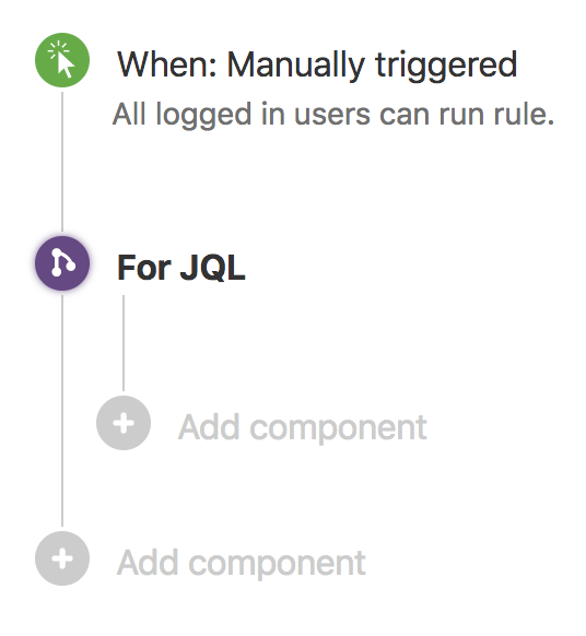

Dave Bosman _Inetum_
February 17, 2022
Hi @Fabien Frances
You need to add a "branch rule / Related issues" in your automation instead of the "if"
In type of "related issues" you need to select "JQL" and add your JQL in that screen.
I think that will do the trick. ;)
Regards
Dave
Jack Brickey
February 17, 2022
Yes, as below. Also you likely want to check the box "only include issues that have changed since he last time this rule executed." In the branch rule.
Like • Dave Bosman _Inetum_ likes this
