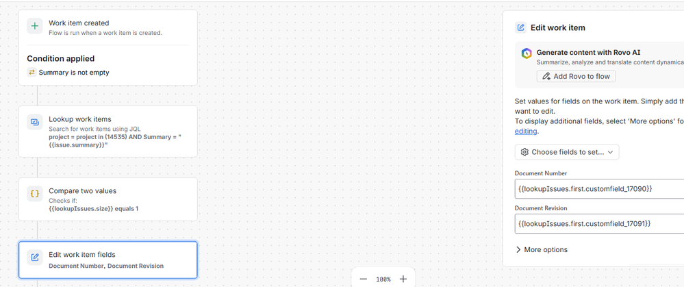

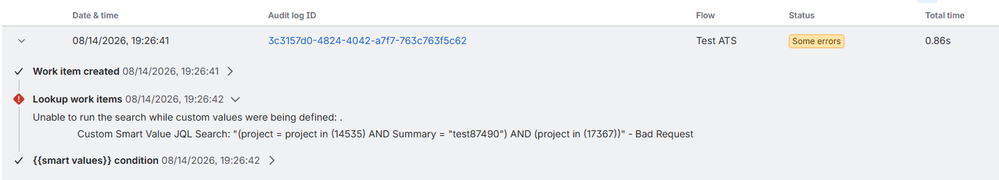

PLaksh11
August 14, 2026
Hi @Cristian Quiroz  i tried this for summary field to check first. and its not working and showing error in audit log.
Thanks,
Prathap DL
Like Cristian Quiroz likes this

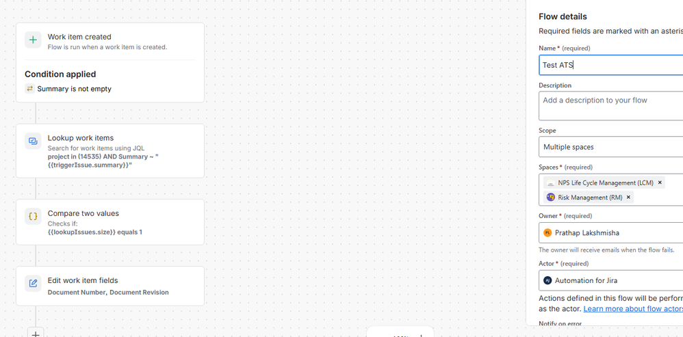

Cristian Quiroz
August 14, 2026
Hi @PLaksh11 ! I found the issue, look at your resolved JQL in the audit log:
(project = project in (14535) AND Summary = "test87490") AND (project in (17367))
There are two problems here:
  1. JQL syntax: project = project in (14535) is invalid. Use project = "14535" or project in (14535)
  2. Scope conflict: Your automation rule scope is set to project 17367 only. Jira appends AND (project in (17367)) to the Lookup JQL — this contradicts your project in (14535) condition. An issue can't be in both projects, so the lookup will always return zero results.
Fix: Edit your automation rule scope to include both projects (the trigger project AND the Master Project where you're looking up issues). Or set the rule scope to Global so the Lookup can search across projects without restrictions.
