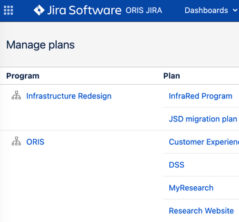

Our use case is that we have programs that contains multiple plans. The Program view provides an easy way to see the status and progress of each Plan in the program.
I think you are saying that Advanced Roadmaps Cloud does not have a way to set up Programs that contain one or more Plans.  Here's what our server Adv Roadmap Program/Plan view looks like.
Is there a similar view in the Cloud?

Marc -Devoteam-
November 15, 2023
Hi @vthomas9
Yes, there is no program view in Cloud.
This as mentioned in my statement why.
To differentiate, I would use a prefix on your plan names as a best practice.
