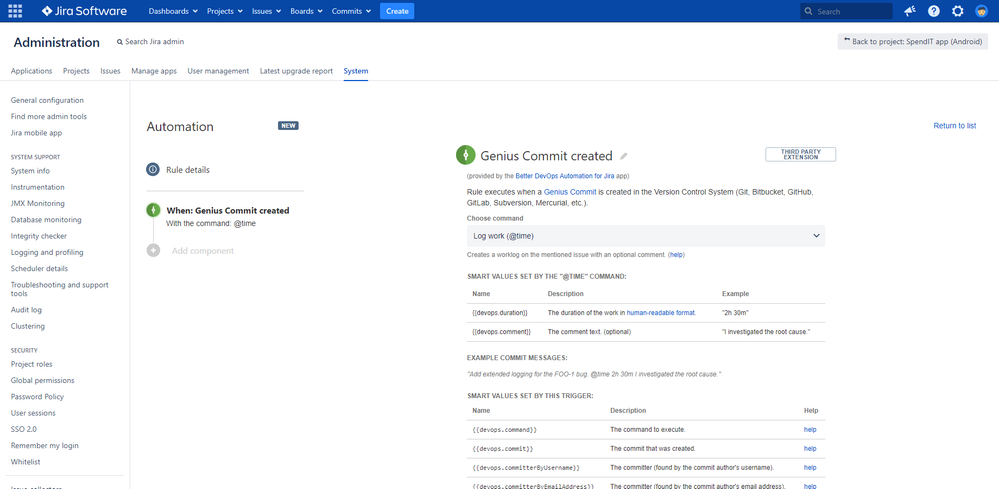

Aron Gombas
April 5, 2021
It's not totally clear what is the automation you're trying to implement, but the Better DevOps Automation app offers various methods to update or transition issues (along the workflow). You can trigger these automations by commits and pull requests, and its is integrated with Bitbucket, too.
If you describe your use case in details, I should be able to give more help.
devops-automation-rule-genius-commit-created

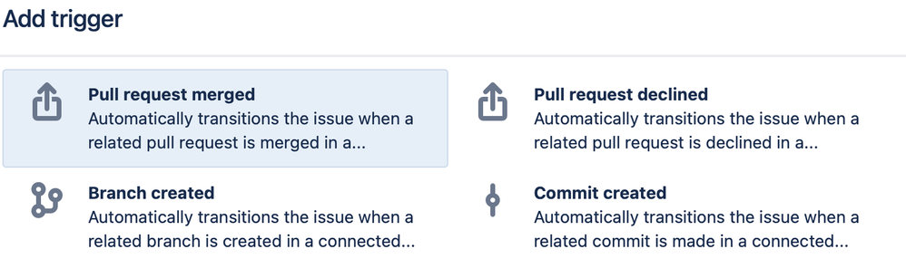

valdes21
April 4, 2021
Hello Ahsan,
You have to add a trigger to some transition in your workflow scheme in Jira. There are 4 possible trigger options in Jira Server 8.14.1:
