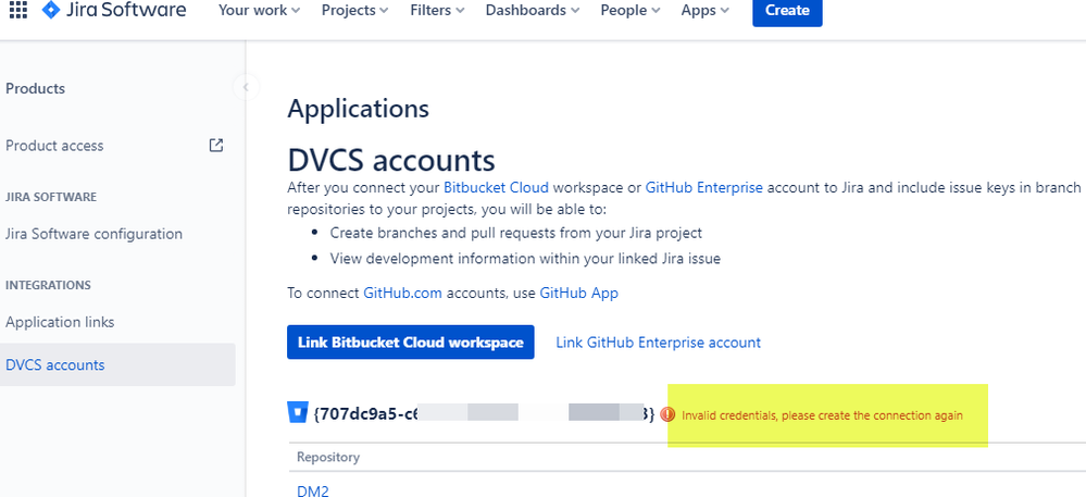

In DVCS accounts (not sure if this is related)
"Invalid credentials, please create the connection again"
Not sure where else to look to get this back working. We have not made any changes in a while on jira end.

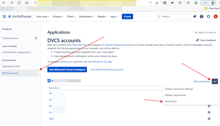

So I just decided to take the chance and disconnect Jira and Bitbucket. Then I reconnected them and it worked. It walked me through the steps (3 I think) and I was done. Took like 3 mins.

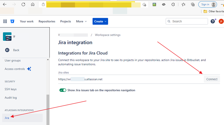

It may worth a quick try: if you can't create the link starting from the Jira side, you may want to try creating it starting from the Bitbucket side.
(Motivation: If the bug that disallows this exists in the Jira side, you may work around that with this trick.)

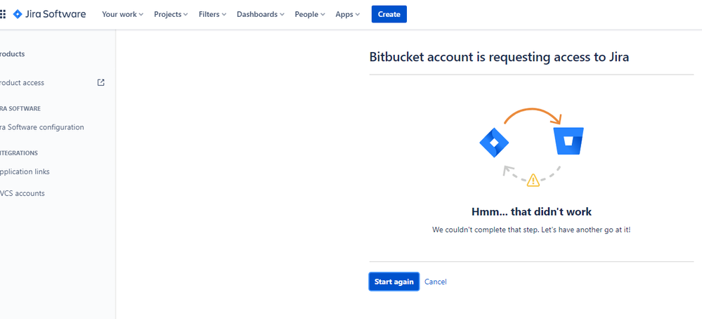

Thanks, I tried that but I got an error "Hmmm... that didn't work"
I am having the same issue and received the same message when trying to recreate the connection.
