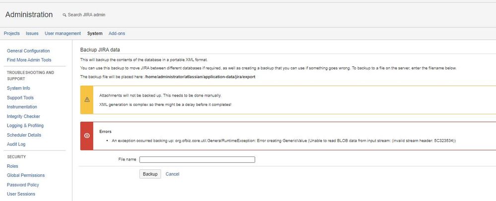

When I perfom backup from JIRA (from Backup System)
I always get the error:
An exception occurred backing up: org.ofbiz.core.util.GeneralRuntimeException: Error creating GenericValue (SQL Exception while getting value: (Invalid column type: getBLOB not implemented for class oracle.jdbc.driver.T4CLongRawAccessor))
