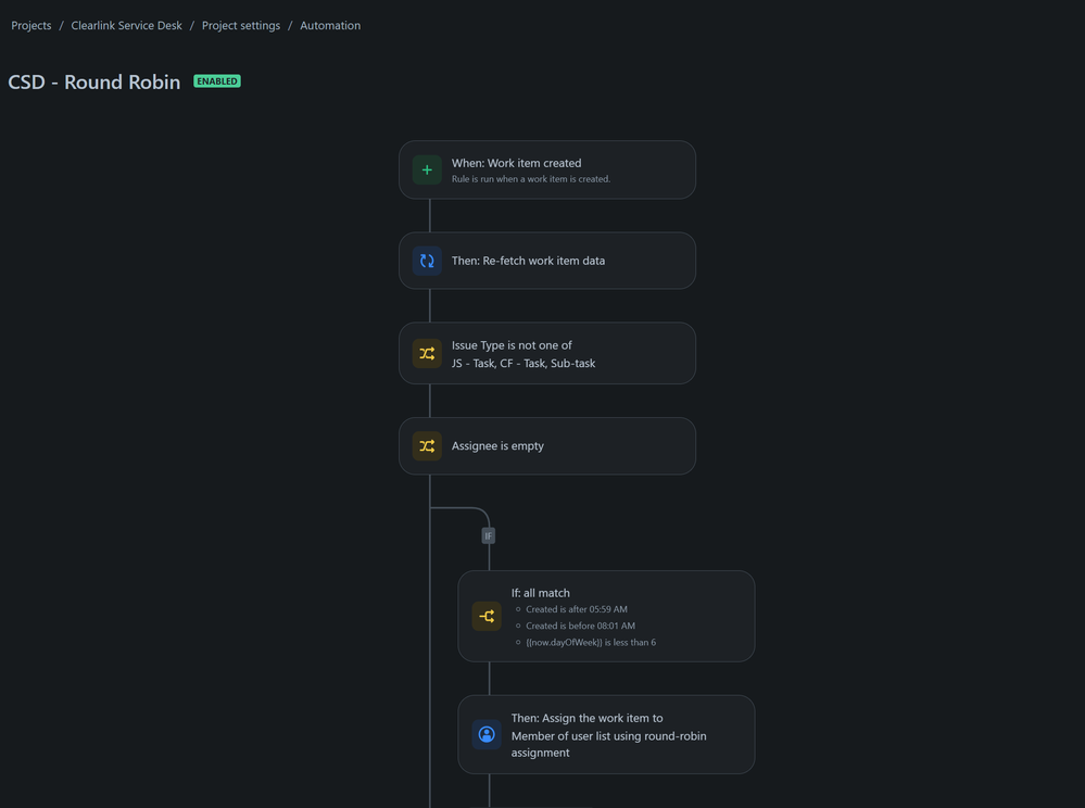

Ty Foster
May 5, 2025
Hey Bill,
Thanks so much for the tip!  Does this appear to now be set up in the way it should be based on your understanding?  Apologies for what may be a simple question here as I'm very new to managing Jira automations.
Like Bill Sheboy likes this
Bill Sheboy
May 5, 2025
Yes, that is correct.  Please test to learn if that helps the conditions pass when expected.

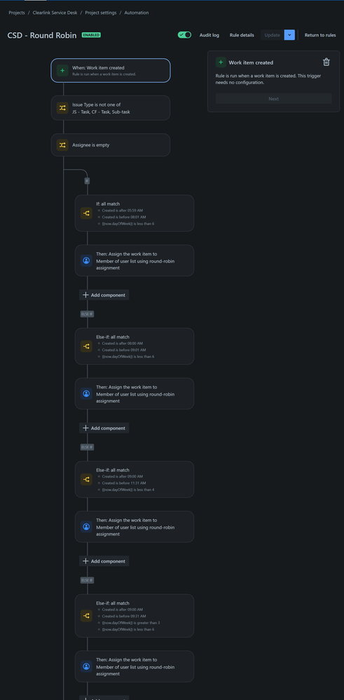

Ty Foster
May 1, 2025

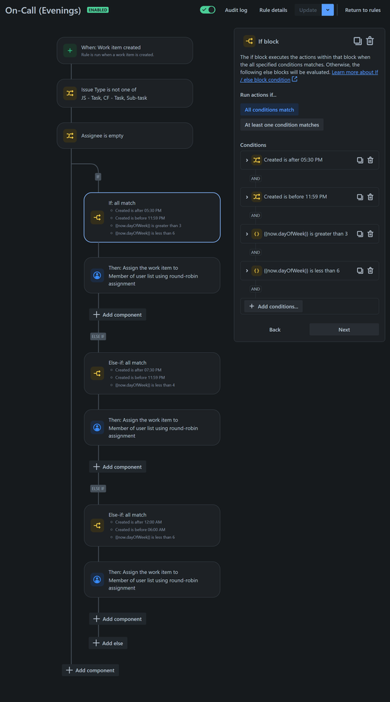

Attached are the two automations in question.  The first is for our evening on call support engineer.  As you can see it is set to only operate on Thursdays and Fridays, yet yesterday (on a Wednesday) it was assigning tickets.
The second is the normal working day automation and should have been assigning tickets during that time frame yesterday but wasn't.  I even tested turning off the on call automation to see if the normal working day automation would work but it still didn't.
Again, this was all working fine until yesterday to my knowledge.

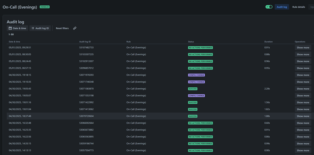

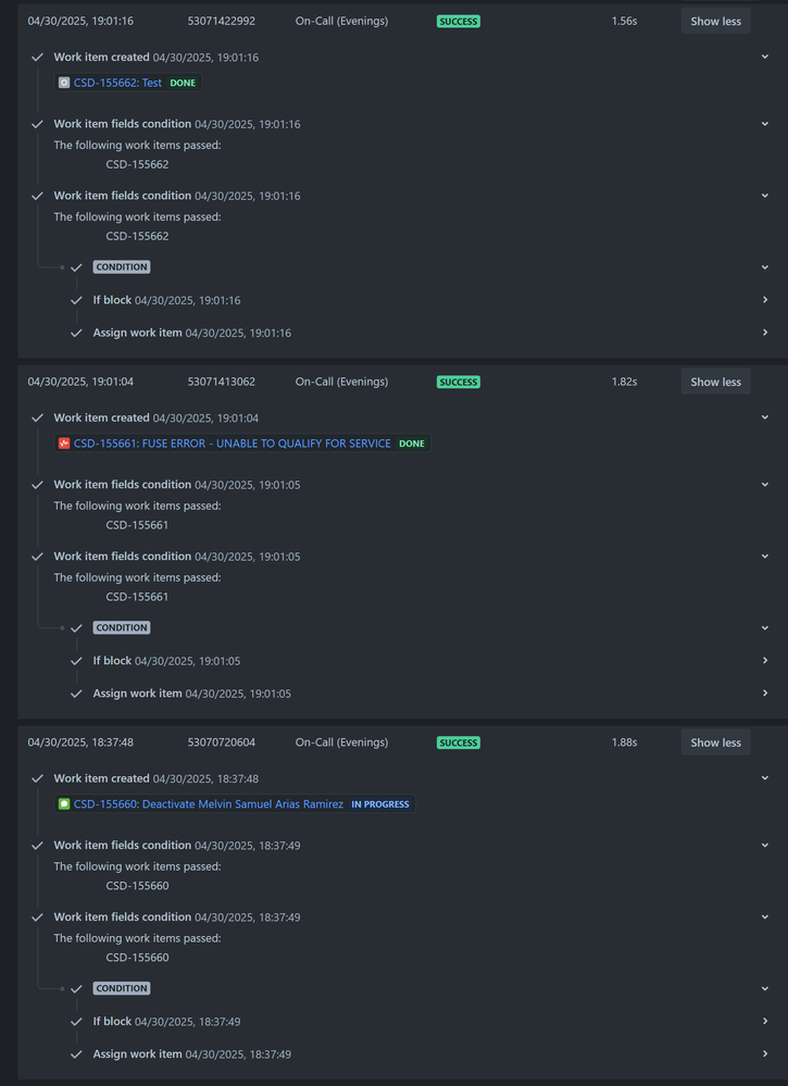

Ty Foster
May 1, 2025

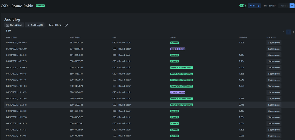

The highlighted row is where the issue began.  The on-call rule should not be touching this issue, but it is.  Additionally, the round robin rule should be assigning it during this time frame, but it's not.

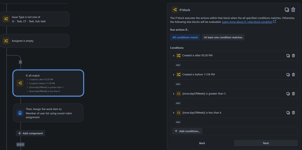

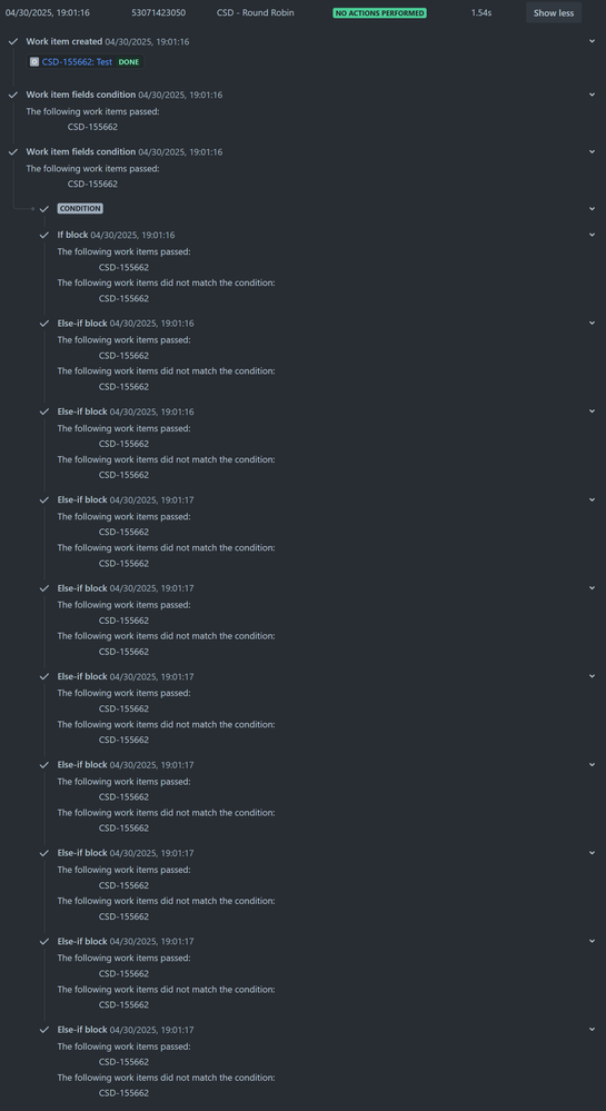

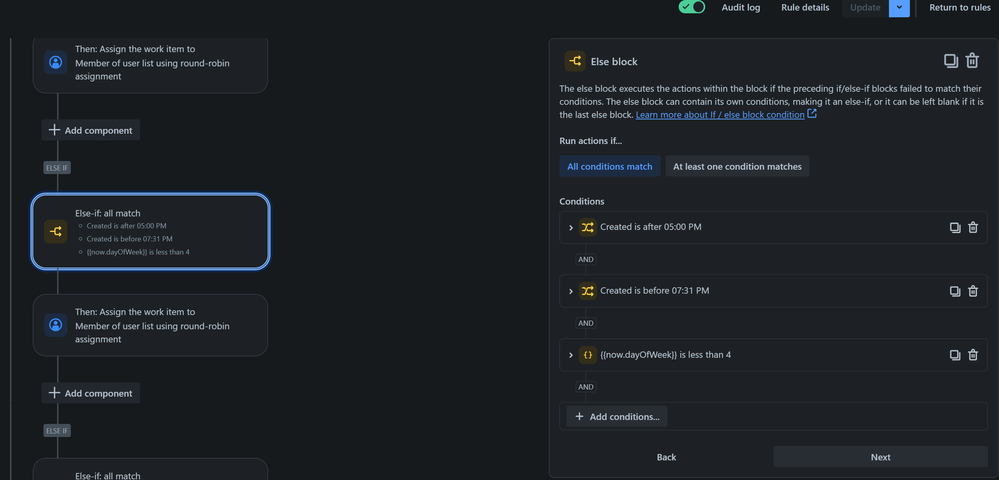

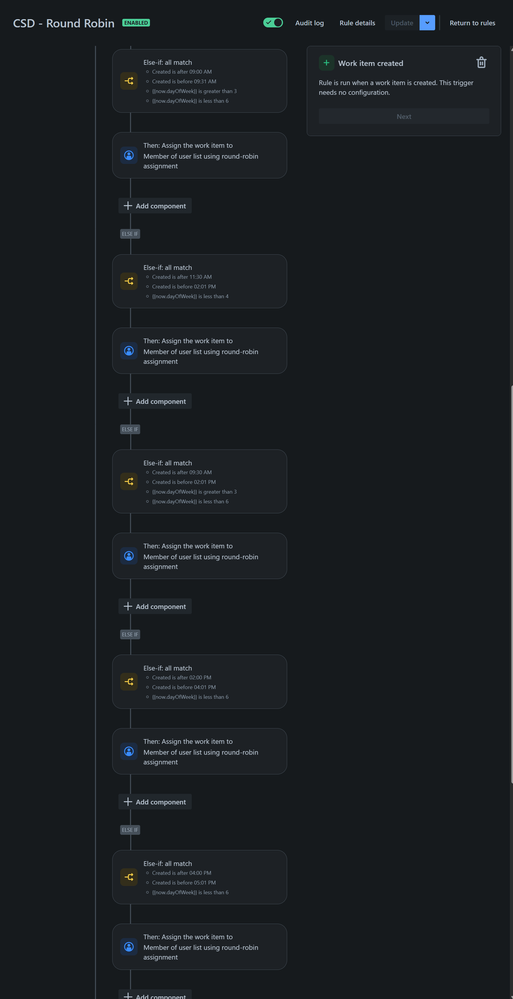

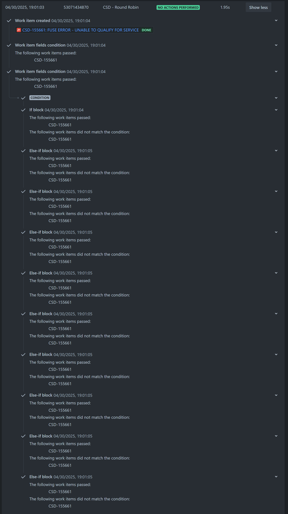

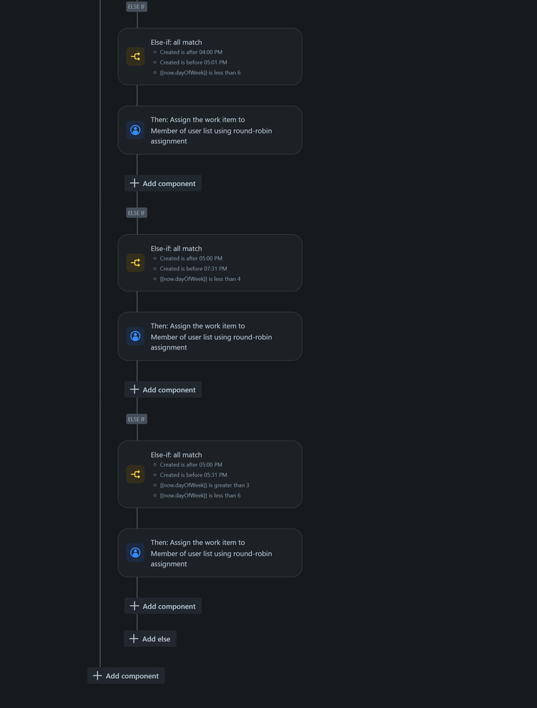

Ty Foster
May 5, 2025
Screenshot 2025-05-05 111859.pngScreenshot 2025-05-05 111823.pngScreenshot 2025-05-05 111553.pngScreenshot 2025-05-05 111421.pngScreenshot 2025-05-05 111232.pngScreenshot 2025-05-05 091929.pngScreenshot 2025-05-05 091909.pngScreenshot 2025-05-05 091813.png
Please see the attached photos of the full rules and expanded audit logs. Let me know if you need any other information.
Please note that for the "if block" for the on-call rule that is linked in the logs is the one shown in the screenshot.
