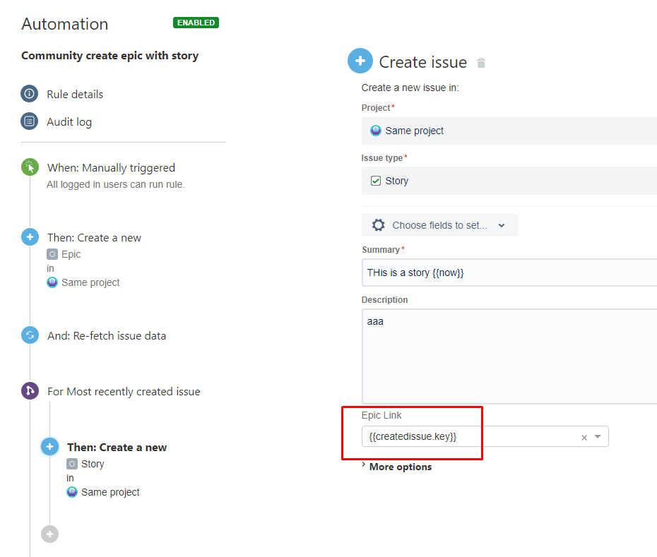

Hi @Don Hames
Use the following rule. This worked for me on my instance:
Bill Sheboy
December 12, 2022
Hi @Don Hames
Yes, and...to Alex's answer:
As you want to add multiple stories linked to the issue, when setting the epic link within the branch please use {{issue.key}} as that will refer to the epic in the branch.
If you instead use {{createdIssue.key}} that will refer to the last issue created, and so the second story added will attempt to refer to the first one, and so on, leading to errors.

Thank you, @Bill Sheboy and @Alex Koxaras -Relational- Your suggestion worked the first time, and I can now create multiple Stories in my Epic. This is just what I needed, and thank you for such a quick response.

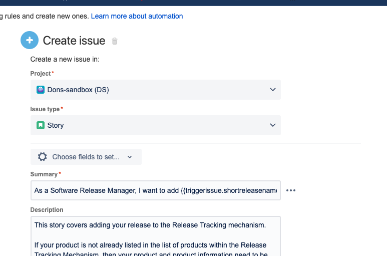

Just one last question on the same subject, I need to create the Stories in a separate project from my Epic. It's working only because I enter the other project's name on the Create Issue:
Can the destination project name be overwritten with the More Options JSON script?

I would expect to use a smart value on the project placeholder, rather that JSON of the below field. Project and summary (and reporter) are the required field to create any issue on Jira. What exactly is the business requirement?

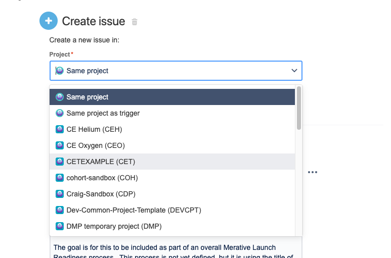

Don Hames
December 12, 2022
@Alex Koxaras -Relational-  I have a master project with all the master records in hierarchal order. The lowest level issue specifies what Epics and Stories I need to create. I am putting the Epics in the same master project, but the Stories need to be created in the team project that will be doing the work. When I use the Create Issue action, it has a dropdown list of what project I want to create the issues in. I need to be able to take the project name from the master record in the main project and use it to specify the target project where the stories are the be created.
I don't see a way to turn off the project dropdown on the Create Issue action.

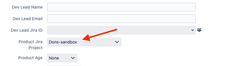

Don Hames
December 12, 2022
It is a field in the main project and is a Project Picker (single project) control. So the information is there. I don't know how to create an issue and use the field to specify the target project:

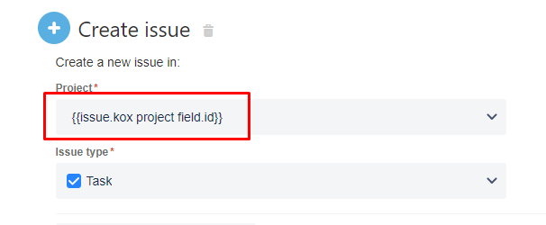

December 12, 2022
On the create project field, enter the following smart value:
{{issue.product jira project.id}}
The only thing you have to make sure, is that the destination project has the specific issue type you are trying to create. E.g. if you are trying to create a story, then your destination project's issue type scheme, must include the story issue type.
