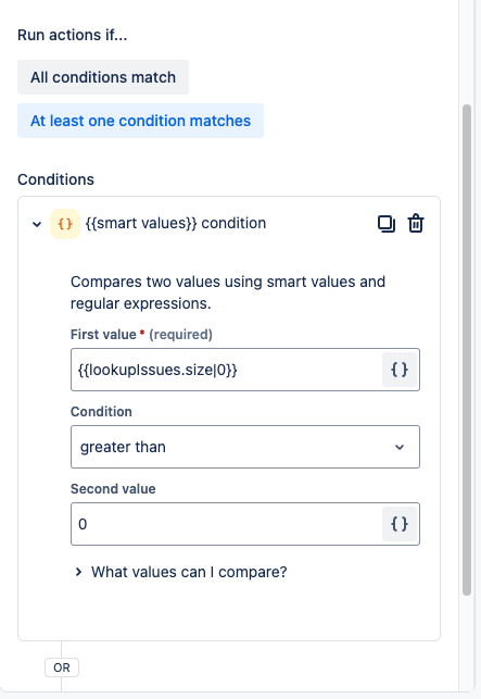

Then in your IF-Else block in the first IF where you are checking for Timespent on the issue, change the condition set to be "Any of" and add this smart value condition
If any subtasks with Timespent are found, then the size of of result set in Lookup Issues will be greater than 0.
So if either a subtask has Timespent or the main issue has Timespent, transition the main issue back to In Progress.

It also has to be plural, as in the example I provided.
{{lookupIssues.size|0}}

@Trudy P Claspill I just got back from vacation, updated "{{lookupIssues.size|0}}" correctly, tested, and it worked!
I will do some more testing and let you know but this is great!
Jason Krewson
September 5, 2024
Testing went well, I tested every combination I could think of and it only deleted when there as no time in the Story and the subtask so its perfect.
