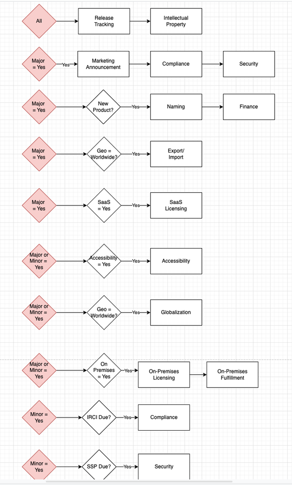

Thank you for your quick replies. Below is a screenshot of the rules that need to be processed from a single manual trigger. I already started breaking it apart. The pink decision symbol s the primary condition; if there are additional, they are the white decision symbols. The rectangles represent an Epic that will be created, and each Epic can have from 1 to n Stories.
My current thinking is to write each line with a pink decision symbol as a separate rule and have it trigger off the same manual trigger they all will use. Do you see any issues or have other suggestions?

Don, what do the rectangles represent in your diagram?  For example, is all of this logic to set the value of one field?  Or is it to take additional actions?
Let's say this was to set the value of one field.  In that case, much of that logic can be combined into a single conditional statement.
Would you please post an image of your rule, as you currently have it?  Thanks!
Don Hames
December 15, 2022
Hi Bill. The rectangles represent a set of Epics and their associated Stories. When the conditions are met, a new action to create an issue is triggered, and the created issue has the summary and description for the issues being added.
I figured out a way for the first trigger to be fired manually to activate the other rules, and each rule has its own set of conditions that must be met before the Epics and Stories are created. It seems to be working smoothly at the moment. Thanks for the offer to help.
