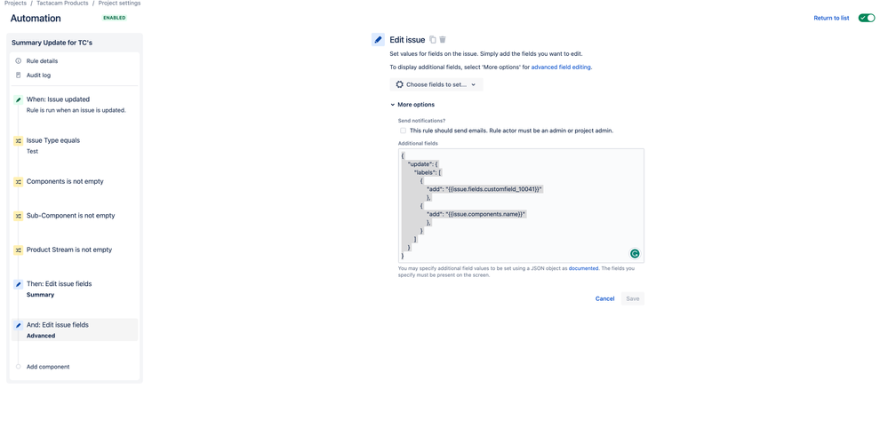

I am in need of an automation rule that (when true) runs the following json script that does smart value lookups for custom Field and Component fields in the ticket and adds them as Labels in the ticket.
I have the following for my JSON Body
"update": {
"labels": [
"add": "{{issue.fields.customfield_10041}}"
"add": "{{issue.components.name}}"
I tried this variant with no luck too
"update": {
"labels": [
"add": {
"id":"{{issue.fields.customfield_10041}}"
"add": {
"id":"{{issue.components.name}}"
I have no problem triggering the rule, just getting the JSON action to run successfully in looking up the values. I keep getting "Error while parsing additional fields. Not valid JSON." errors. I've run these same {{issue.etc}} lookup values in other types of rules and they return the expected values. So no issues with getting them to look up values else where (just with lables). Thanks2023-08-13_23-56-04.png

There is a typo in your JSON, try the following and let me know if it works:
"update": {
"labels": [
Sayed Bares [ServiceRocket]
August 14, 2023
Sam Adams
August 14, 2023
Hi @Sayed Bares [ServiceRocket] , Thanks for the quick reply. I did indeed have a typo, thank you.
Corrected things to
"update": {
"labels": [
That solved one issue....but opened another.
I am now getting a new error perhaps you may know too?
The error says "xxxxx (The label 'xxxxxxx' can't contain spaces. (labels))"? The value it returns to me for 'xxxxxxx' in the error is what I am expecting too btw (no spaces I see). Any help is appreciated thx

You may want to try a replace function to get rid of any potential spaces from your code by adding .replace(" ", "") in the field which is causing the error. example:
{{issue.components.name.replace(" ", "")}}
