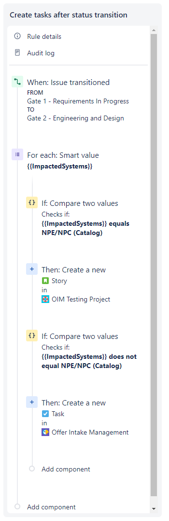

Hello,
I ran into an issue with For each loop with if condition. Any help is much appreciated it!
Goal:
I want to run a "for each" loop based off a custom field with multiple selections, and subsequently create tasks based on multiple "if" conditions.
Example:
There are three "impacted systems" (custom field) selected in the source (epic). For each impacted systems, if impacted system = NPE, then create a task in another project. If impacted system != NPE, then create a task in the current project.
Expectation:
Total 3 tasks created:
  • 1 task created in a different project.
  • 2 tasks created in current project.
Actual:
only 1 tasks created in another project.

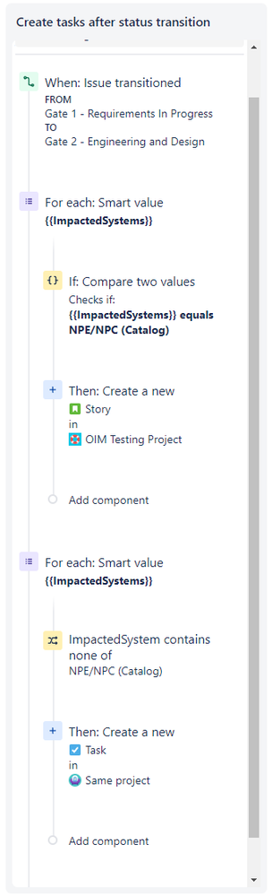

Current Setup:
I also want to make sure this setup can scale up, because there will be additional impacted system selected that results in additional tasks created in other projects.

Hello @Garret Zhang
The version you have will not work. At the first point where a condition is not met, processing for the current issue in the loop will stop and the loop will proceed with the next issue.
Currently Automation doesn't support using IF/ELSE inside a Branch, which is exactly what you need to do.
I advised another poster with the same type of question to set up multiple branches with each branch containing one condition:
For <your branching information>
If Condition1
Action that goes with Condition1
If Condition2
Action that goes with Condition2
I'm not sure if that matches your need for scalable, but it does work.

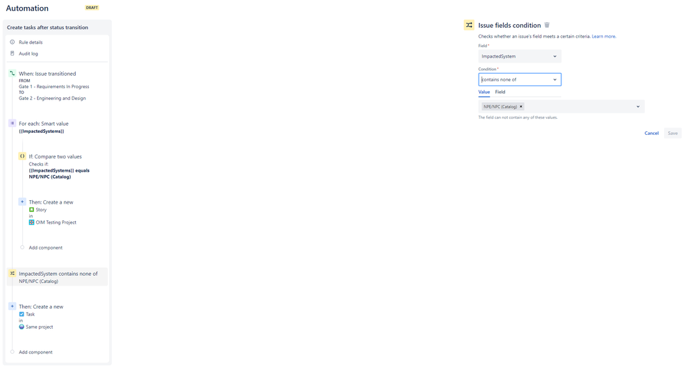

If the custom field is a selection list field then I advise you to use an Issue Fields condition rather than a Compare Two Values conditions. You can then use the "is not one of" to specify multiple values that you want to ensure are not present.
Garret Zhang
March 9, 2023
this did not work for me :(
For the last 3 components, I want to say if system did not = npe/npc, then create tasks for all other system in our project.
There were 3 system selected: 1 was created in another project, the other 2 didn't run.

Trudy P Claspill
March 9, 2023
I see that you are using a For Each Smart Value, and I have just realized this is likely related to another post from you that I answered previously.
https://community.atlassian.com/t5/Jira-Software-questions/Automation-for-JIRA-Create-multiple-stories-based-on-values-of-a/qaq-p/2292036
Since you are using a smart value and branching on the values in a field, my original advice to use an Issue Fields conditions is completely incorrect. Sorry about that.
Either before or after your For Branches that check if the value matches a single explicit value, what you will need to do is have a simple Issue Fields condition to check the original field
If Condition1
If Condition2
IF: field issues condition
<original field> (not the Smart Value used in the branched)
is not one of
<the multiple values you specified>
THEN: Action: Create issue

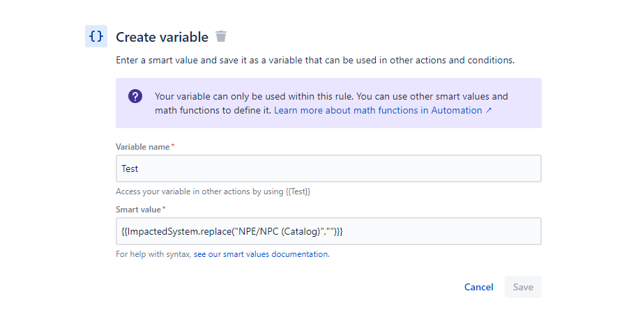

I thought about this more, is it possible to set a new variable by removing certain "impacted systems" from the list? something like this:
I'll need to remove multiple "impacted systems". After removal, I'll want to use this new variable to run the for loop? I couldn't get this to work though, let me know what you think.
