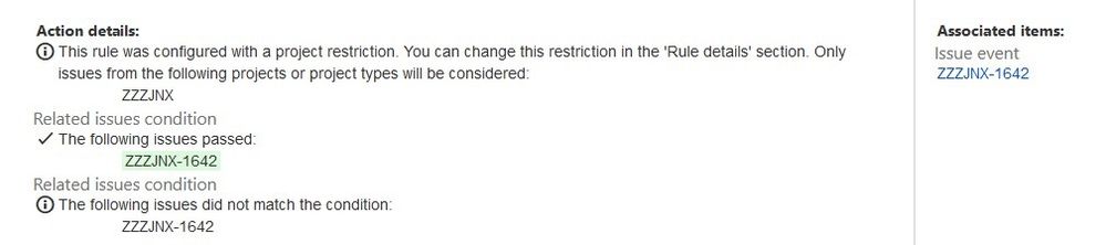

Yes, I´m working in the same project. And I would share the Audit logs as well if there would be something relevant, I rather would use them to solve the problem on my own but there is nothing helpful there. E.g. :

Bill Sheboy
December 2, 2024
Thank you for that information.
Regarding link direction, the rule only triggers one time when two issues are linked, not once for each issue.  If your link could be added from either issue (by choosing the relevant direction), you would need an if / else block to handle both possible cases:
  • if / else block
    • condition: issue type equals Risk
    • branch to Destination issue
      • condition: issue type equals Problem
      • action: edit the issue
  • else / if
      • action...
