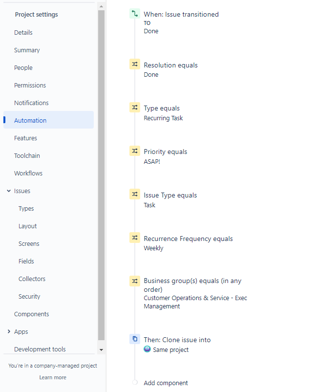

I'm relatively new to Automation and json. I copied existing, working Automation from a team-managed project to apply to a new company-managed project. But, the automation is not working in the company-managed project. All fields are on the screens and conditions were met in the test issue. What's wrong with this Automation?

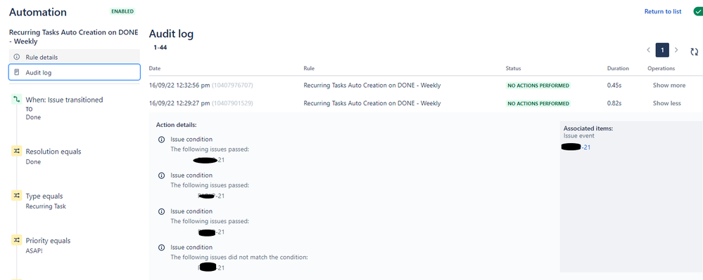

Please explain what exactly you mean by the automation is "not working".
Please show us the Audit Log for an execution of the Rule where you did not end up getting the expected results.
Apryl Harris
September 16, 2022
Not working = i expect a cloned issue would be created with an issue is transitioned to Done. the cloned issue is not created. Log is attachedAutomation Audit Log.png
Trudy P Claspill
September 16, 2022
Based on the image you provided, the issue that triggered the rule execution did not match your fourth condition
Issue Type = Task

Apryl Harris
September 16, 2022
But, the issue type = Task. See upper left corner.
However, it got me to thinking that I may just need to refresh the field selections even though I made the custom fields with the same name for the company-managed project.
And voila!!! The automation was successful. The Clone was created and went to the first status of the workflow!
THANK YOU ALL VERY MUCH!!

Mark Segall
September 16, 2022
Yeah even though the original automation rule was a Task, behind the scenes, Jira sees team-managed project issue types completely different than issue types on company-managed projects.  So, refreshing the condition to look for Task again was an important step.

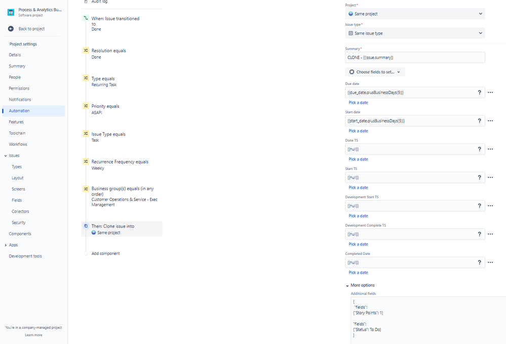

Hi @Apryl Harris
You don't need the Advanced section.
  • Story Points - This is a standard field so you should be able to add it from the Choose fields to set dropdown
  • Status - You're not going to be able to set this.  When you clone issues they will be created with the first status in your workflow.  So if To Do is your first status, you should not have to do anything.  However, if that's not your first status and you want it to transition, you'll need to add a couple more steps to your automation after your Clone:
    • BRANCH (Recently Created Issue)
      • ACTION: Transition issue to To Do

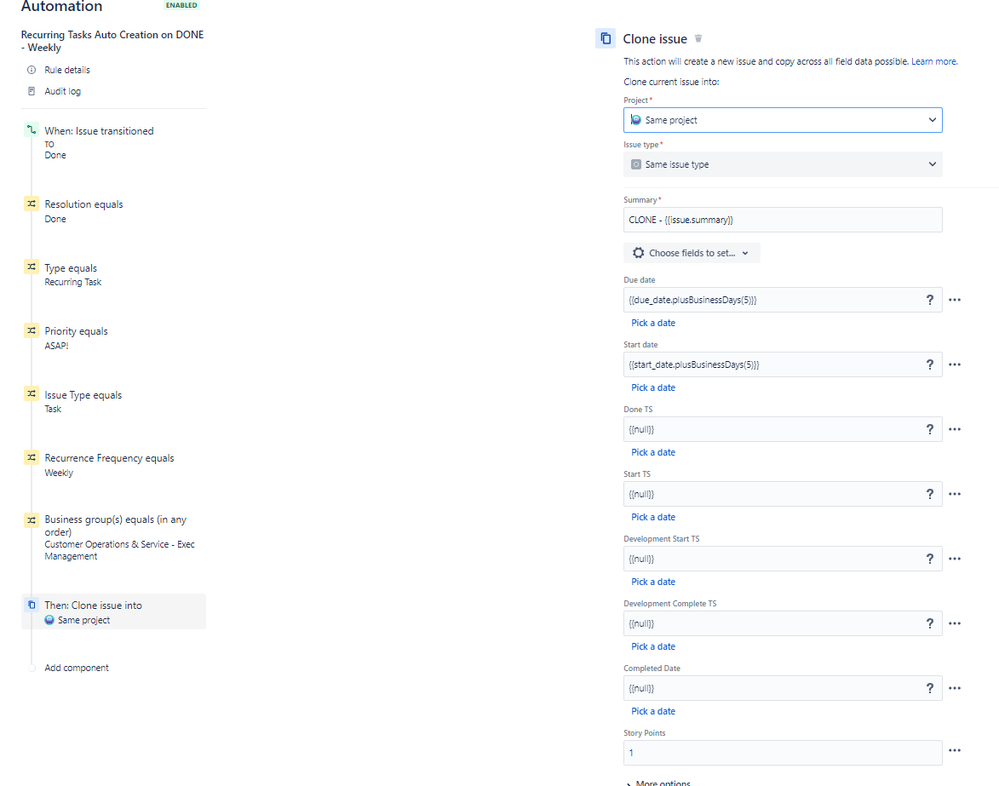

Apryl Harris
September 16, 2022
I selected Story Points from the dropdown; and did remove the json from the Advanced section.
I just entered the value for Story Points as 1 (this would be the value for the cloned issue). Is that correct, should I have entered it as {{1}}, or some other format?
Thank you.
Mark Segall
September 16, 2022
Yes this should be correct.  Note per the response from @Trudy P Claspill, your rule is working as designed.  Your condition is failing for issue type = Task.
