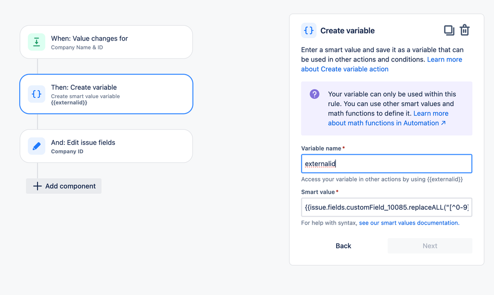

I see you are trying to use single-quotes within the replaceAll() function, with that then nested within double-quotes for the JSON expression.  That will not work: those all need to be double-quotes within the smart value expression.
One work-around for that is to perform the replacement first, saving the value in a created variable.  Then use that created variable in the JSON for the advanced edit.

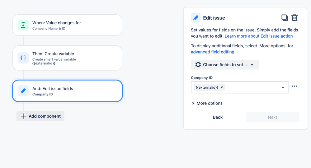

Huzzah!  The combo of using the create variable and using double-quotes fixed it and it's now working :)
This is what I ended up with - using the Create variable function and replaceALL smart value (with double-quotes) then using that created variable to add to the other custom field.   Thank you for your help!

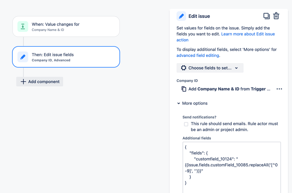

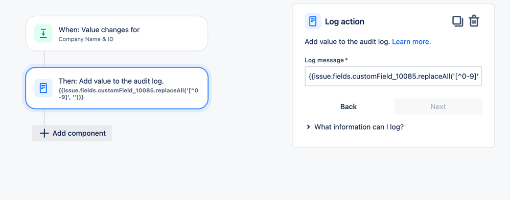

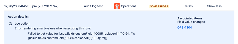

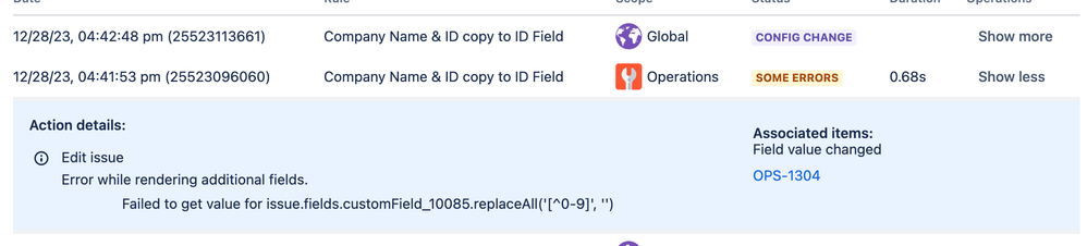

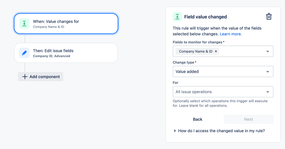

Here are the screenshots of the rule I've been trying to build out (I've removed the extra steps to refresh data.
Note `customfield_10124` is the target where I'm trying to copy the numeric value to and `customfield_10085` is the source where the alphanumeric value is located.
I just tried again by switching to replaceAll but I don't think I'm using it correctly.
Also tried generating a log action and I'm getting the same error (or looks like it's the same).
For additional context the two custom fields are "Label" type fields if that's helpful or if either of you know if those are not supported.Screenshot 2023-12-28 at 4.46.22 PM.pngScreenshot 2023-12-28 at 4.46.42 PM.pngScreenshot 2023-12-28 at 4.48.31 PM.pngScreenshot 2023-12-28 at 4.49.48 PM.pngScreenshot 2023-12-28 at 4.49.34 PM.png

Have you try to use double quote instead of single quote?
Let me know of your findings.

Yes thank you for your help!  The double quotes and using the variable was the key to get it to work. I added the automation I ended up with above for reference.
