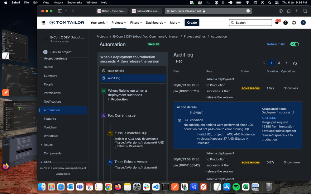

When we add a condition to release the version(Status!=Released), automation not running and throwing the below errorScreenshot 2023-07-06 at 9.24.44 PM.png
Bill Sheboy
July 6, 2023
Reviewing the audit log, it appears your release names have non-alphanumeric characters in them.  Please try wrapping the smart value in quotation marks to make that work.

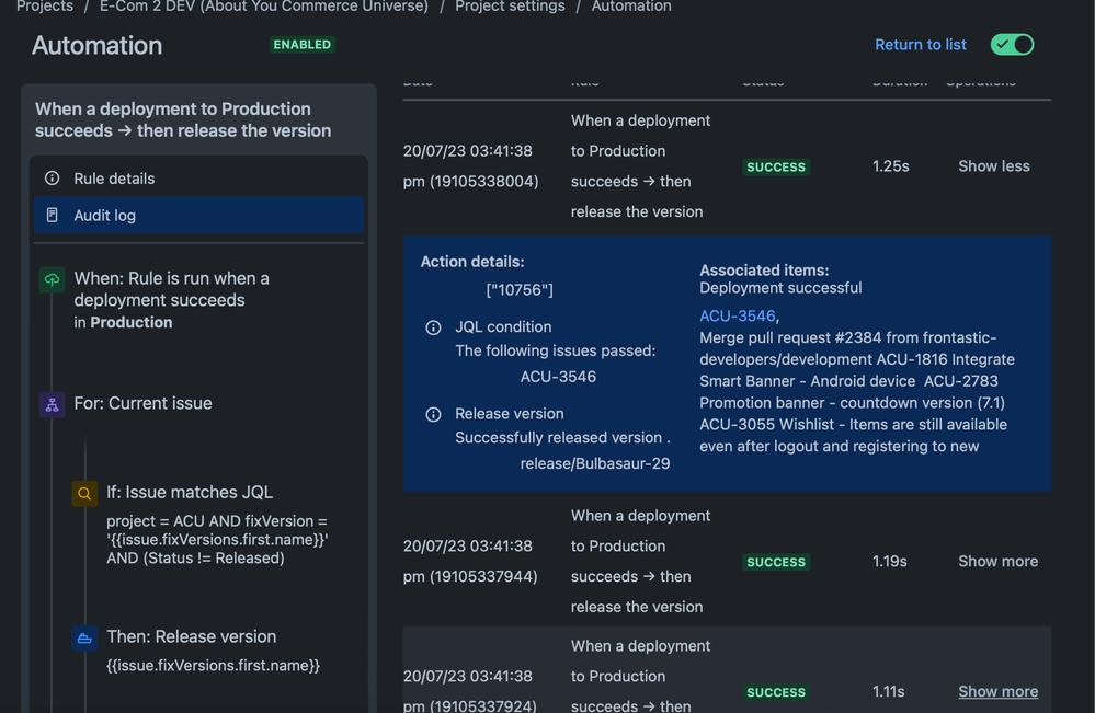

After updating the JQL, notification sent 4 times, how to update the JQL to run the release version only once and not trigger for each ticket that's releasedScreenshot 2023-07-24 at 12.42.40 PM.png

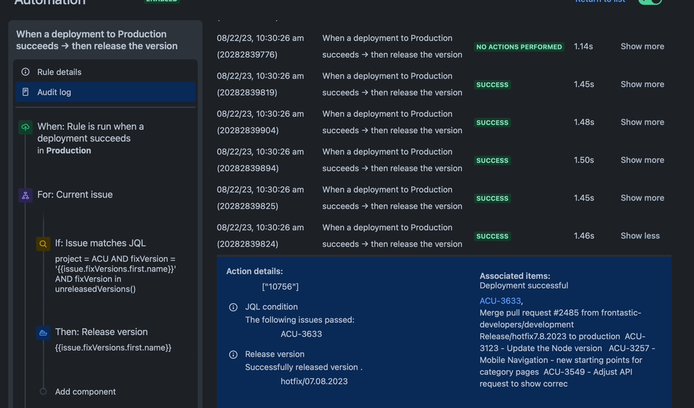

Deleted user
August 21, 2023
Added a JQL condition project = ACU AND fixVersion = '{{issue.fixVersions.first.name}}' AND fixVersion in unreleasedVersions() to check if the version is unreleased to release the version, we expect the automation to run only once here but we are seeing multiple times action ran.
Can you please suggest a way to update the JQL to release the version only once
Bill Sheboy
August 22, 2023
I have seen this symptom posted before, and I believe that is how that trigger works: once for each issue impacted.  And so there probably is no perfect way to solve this due to parallel processing and timing issues.

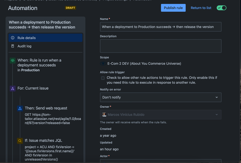

Deleted user
August 28, 2023

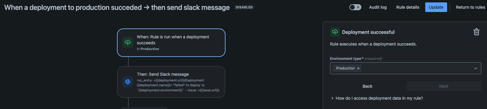

Added web request call and it looks like web request call runs for 0.6 seconds.
Are you saying the time delay will help the JQL to check if the version is released already?

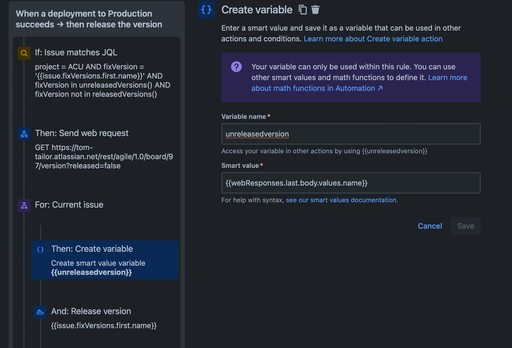

August 28, 2023
If I assign smart value as {{webResponses.last.body.values.name}} all the unreleased version names are listed in comma separated like below
release/Caipirinha, release/Moscow-Mule-33
Can you suggest how to check if the version name in deployed task is equal to any one of the names listed Eg : {{webResponses.last.body.values.name}} = {{issue.fixVersions.first.name}} in JQL?

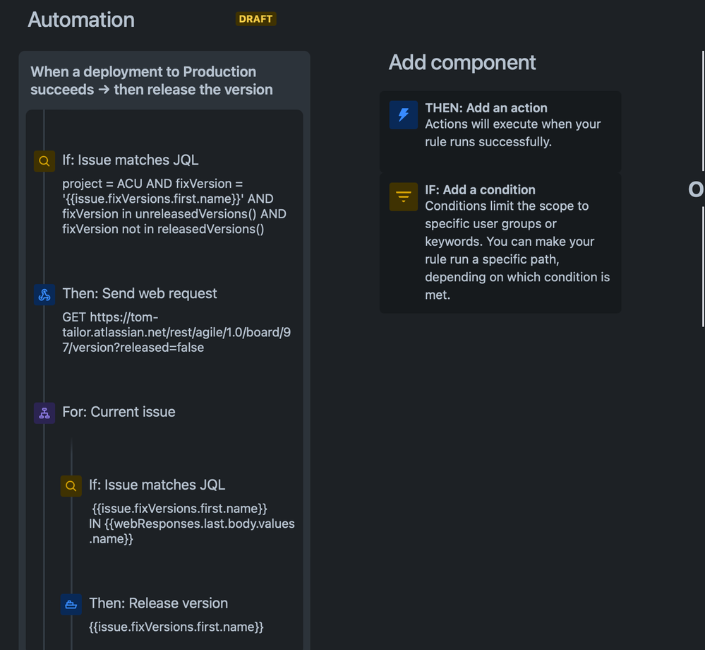

Deleted user
August 28, 2023
We have 2 unreleased versions, I filtered the ones that are not released using 'released=false' in the web request.
Which resulted in release/Caipirinha, release/Moscow-Mule-33
Are you suggesting adding a IF condition with JQL {{issue.fixVersions.first.name}} IN {{webResponses.last.body.values.name}}?
I will test and let you know how this works

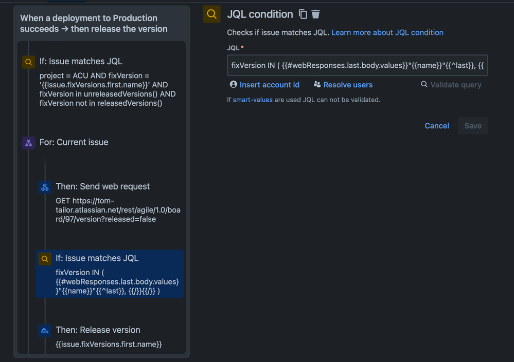

Bill Sheboy
August 28, 2023
Almost correct...
JQL is a simple language, and the left-side of expressions must be an issue field, not a smart value. So you want something like this:
someField someOperator someValue
When in a rule, that field is based on where you are in the rule.
You have a branch on current issue, and so the left-side would be the fixVersion field, and the right-side would be a formatted version of your webrequest response:
fixVersion IN ( {{#webResponses.last.body.values}}"{{name}}"{{^last}}, {{/}}{{/}} )
This will iterate over the response, creating a list of the version names to check.

Deleted user
August 30, 2023
Thanks Bill,
