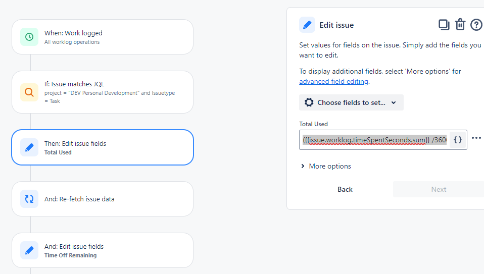

Hello all!  I am currently using this
({{issue.worklog.timeSpentSeconds.sum}} /3600) /8
in my automation which will pull worklogs on an issue and turn it into days and updating a custom field with that.
I need to pull worklogs just for this current year though...I am having trouble figuring out how to do that...any ideas?

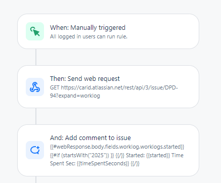

I am trying to pull worklogs for a particular issue but only for this year.  I have tried to use a web request.  But I only need to grab the worklogs for the year starting with 2025.  I THINK the way I need to go about this is use an if statement - maybe then be able to put those timeSpentSeconds into a variable then do a calculation on that variable?
For testing purposes I am trying to just comment on the ticket so I can see what is outputting.
The top pic is how I am currently calculating worklogs using this equation ({{issue.worklog.timeSpentSeconds.sum}} /3600) /8
this allows the seconds to be displayed in days or half days.

Below is what I am currently testing with - I was using this comment before
{{#webResponse.body.fields.worklog.worklogs}}
Started: {{started}}
Time Spent Sec: {{timeSpentSeconds}}
and it was successfully giving me all worklogs on this issue - but how do I get just ones where Started contains 2025?
Right now this is not returning anything
