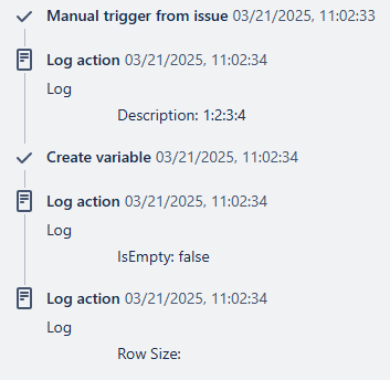

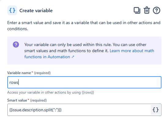

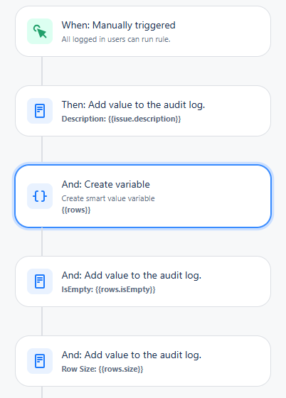

I am trying to write a very simple automation to parse the description field from a story that contains the text 1:2:3:4 and use the Log action to output its empty status, size, and each list item.  What I am seeing is that when I run it, I can output the string in the description, it tells me the smart value is not empty and I can't output the first list item from the split command when I try {{row.get(0)}}.  Any idea what I am missing?  Every example that I have tried has the same result.
Thanks!!!!

Hi @chadunbehaun
Created variables are always text type.  And when you split() the Description field, the result is the rows variable gets this:
  • first the Description is split into a list of text values: [1, 2, 3, 4]
  • and because it is then stored in text, it implicitly performs a join(", ")
  • with a result of: 1, 2, 3, 4
When you later want to return to a list, the split() command is needed again.  For example, to get the size:
{{rows.split(", ").size}}
Tip: The implicit join() is undocumented type conversion behavior, and so I recommend explicitly adding a join() with your desired delimiter to always know what is in there.

chadunbehaun
March 21, 2025
Thank you for the quick response.  Very much appreciated.  That being the case, then how do you reference a row in a advanced branch then?  Assuming the smart value for the branch is still {{issue.description.split(":")}}?

Bill Sheboy
March 21, 2025
Yes, that is one way to do it:
  • advanced branch:
    • smart value: {{issue.description.split(":")}}
    • name: varItem
And inside the branch, reference the item as {{varItem}}
Please note well: this assumes there is at least a non-empty Description field with a colon ":" delimiter and no newlines in the field.
  • When no data is in the field, the branch will not process anything
  • When the branch contains newlines, it may not split() as you expect
The solution is to always test to confirm the behavior matches what you plan.
