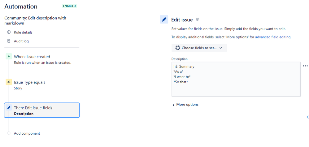

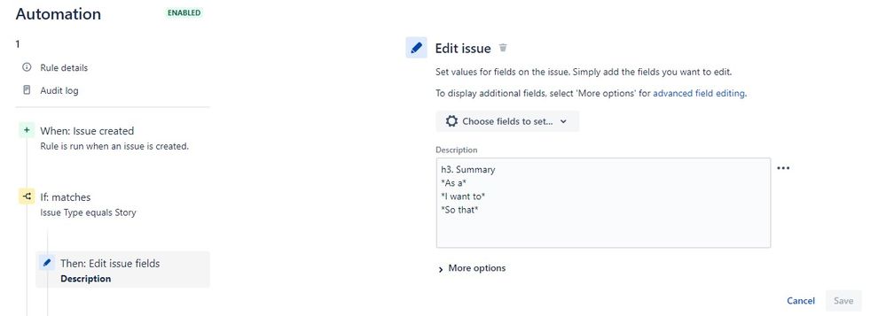

Hello everyone, I am trying to create an automation template for User Stories templates.
I have tried creating multiple automations, by adding a specific Description but it doesn't seem to work.
This is the way I have tried doing the automation.
We are using a company-managed project.
I have written a user story in this format and it worked fine, so I don't know why it's not working.
Any help would be appreciated, thank you :) .

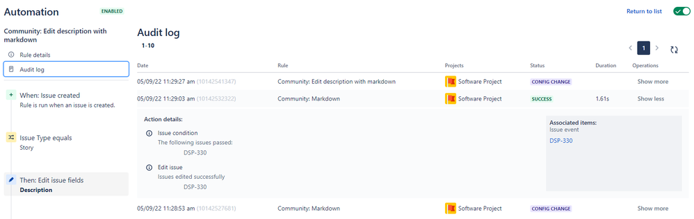

Bogdan Apostol
September 5, 2022
The audit log says the status is SUCCESS (rule completed without errors and performed some actions successfully), but on my end I can't see anything when creating a new story.
Are you also using a company-managed project?
Also, I am not sure what actor I should choose, I am always choosing "User who triggered the event".

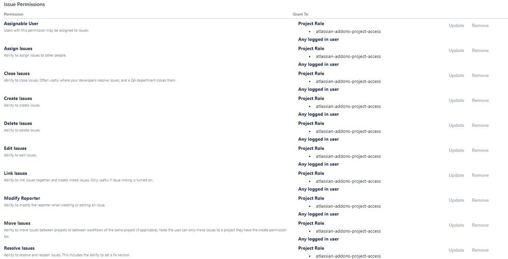

Permissions are set on Project setting > Permissions
However, priori of changing any permission, you should check that the permission scheme does not affect any other project. Share a screenshot of it if you want.
Bogdan Apostol
September 5, 2022
We are using for now the Free version. This is how the permissions look like.
Alex Koxaras -Relational-
September 5, 2022
Did you change the actor as well and tried it again?

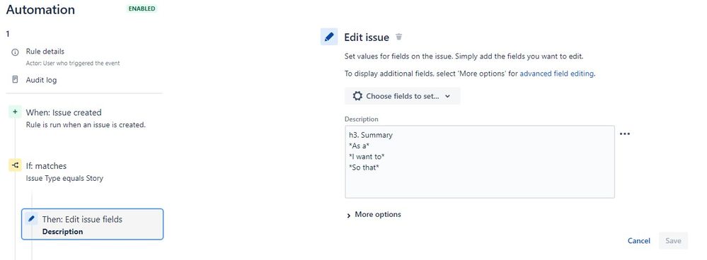

Please post your rule as well as your audit log from the last success or fail issue, which the description didn't change.
Bogdan Apostol
September 5, 2022
September 5, 2022
Bogdan Apostol
September 5, 2022
Yes, the status Config change status is after I changed the actor and still doesn't work.

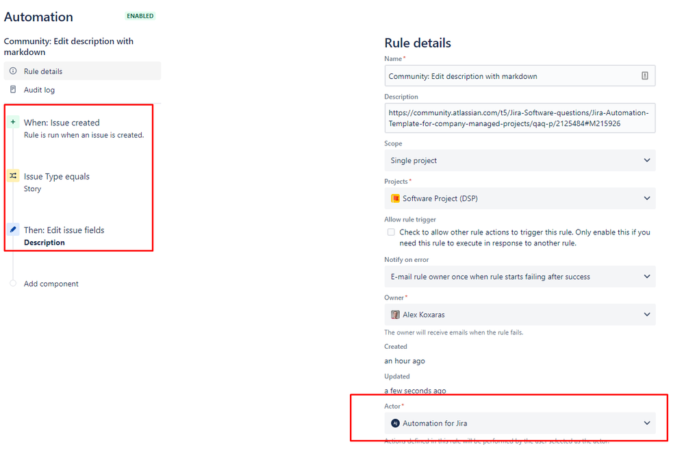

September 5, 2022
Did you change anything on the field configuration for the description field?

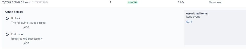

Looking now over detailed Audit log, I can see that under Success I see this.
Opening that story displays the template I have created. It was created by another user.
But I don't understand what means, If block.

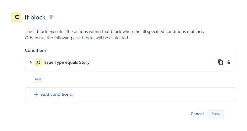

Share a screenshot of your IF component.
Bogdan Apostol
September 5, 2022
I think this could be the issue
September 5, 2022
No, that shouldn't be the problem. It is correct. The "If Block" will evaluate if the issue type is a Story. If that fails, then it will evaluate the "else block". So we are good.
I would propose to delete that if block and create a new one, or add an "Issue fields condition" instead of and if-then-else component.
