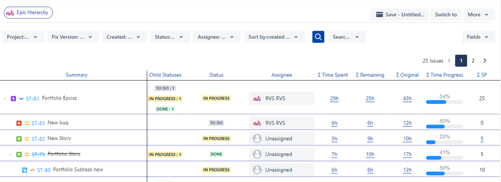

Hi @tinnt
Welcome to the community !!
If you are open for a third party app, you can try out our plugin to get this data.
Agile Tools - Epic Tree, Links Tree and Time in Status
The screen shot below shows the statuses of Child Tickets at each parent level.
There are multiple other important features which the app provides as below.
1) Links/Portfolio/Advanced Roadmaps Hierarchy :- View/Manage roll up for hierarchy (up to 10 levels), based on your Portfolio/Advanced Roadmaps/Issue Links parent child relationship.
2) Epic Hierarchy :- View/Manage roll up for standard Jira hierarchy. Epic -> User Story -> Subtask
3) Time in Status :- More than 7 types of Time in Status reports to track your issues.
4) Worklogs Report :- Track time spent by resources with multiple filters / category / grouping features
5) Timesheet :- View/Enter your time spent for multiple days
