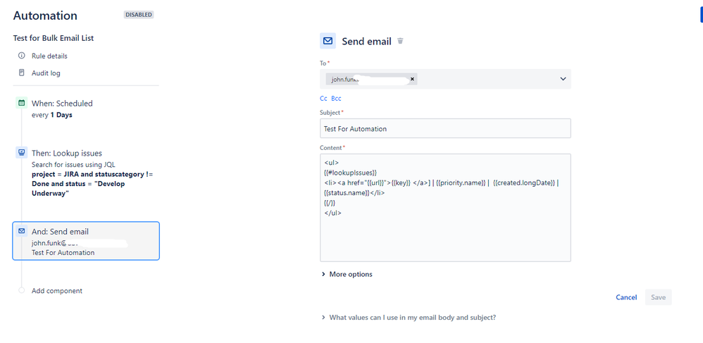

Hi Dayana,
Here is one I use and it works great.

@John Funk Thank you for the suggestion. I am still receiving an email per each issue.
John Funk
May 27, 2022
Can you share your rule?
