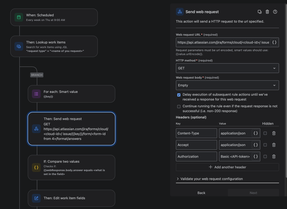

On the web request action in the authorization of the call, is the email:apikey converted to base64 and noted as Basic <result of the conversion>
Example:
Federico Frade
August 7, 2026
Yes, it is; in fact, at one point when I had this set up incorrectly, the error was a 401.
Looking at your screenshot, I saw that you had the "Accept: application/json" header set, and I have the "Delay execution of subsequent flow actions until we've received a response for this web request" option checked, so I add this header, but even after that, it still returns the same 400 error.
