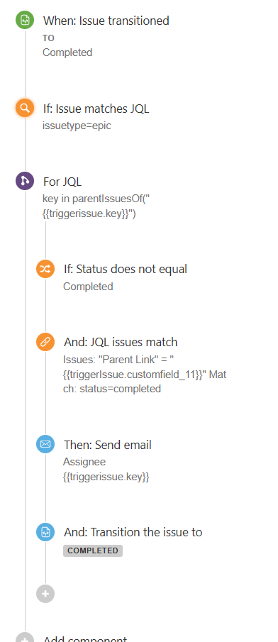

Sabina Tangaro
May 13, 2025
Hi, yes I refer to Epics child items under initiative, and Epics and initiative are all in the same project. I'm project Administrator.
I've already created more automation rules like complete an epic when all related user stories are completed. Here is a screenshot:

Trudy P Claspill
May 13, 2025
Thank you for the additional information.
Is that rule image from the same system where you want to create your new rule? If so, based on the icons in it this concerns a Jira Server or Jira Data Center system, not a Jira Cloud system as indicated by the Deployment tag for your post.
Are the Initiative and related parent Epics all in the same project?
The screen image you provided appears to be a rule for updating the parents of Epics based on the change of the Status field of the Epic. If Initiatives are parent issues for Epics it seems like this rule would apply, if the pictured rule is on the target Jira instance.
Is this rule not working? If the rule is not working, describe how it is not working. Are you transitioning an Epic to Completed? Is the rule getting triggered? What is the output in the Audit Log when the rule executes?

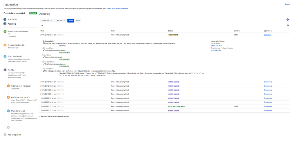

Sabina Tangaro
May 14, 2025
Sorry, you are right we are working on Jira Data Center system.
All Initiative and Epics belong to the same project.

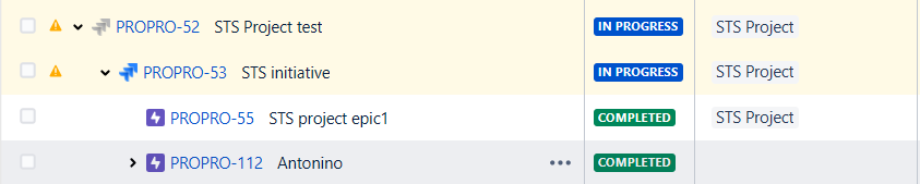

My purpose is to create a rule that set an initiative to completed status as all its child epics are set to completed status, in particular when the last child issue (epic) status transit to completed.
Here is a hierarchy:project Initiative-epics.png
I changed the epic "PROPRO-55" status from progress to completed, but the initiative "PROPRO-53" did not change its status from progress to completed.
Could you please help me on it?
BR Sabina
Trudy P Claspill
May 14, 2025
Thank you for that additional information. That is very helpful.
First the "some errors" status of the rule is referring to the problem with the Send email action having no value for the To field.
Second, by using the parentIssuesOf() function you are getting both the direct parent and the grandparent of the Epic. I think you don't want the grandparent, do you? So you might want to add a Condition within that branch to check that the issue you are working on in the branch is an Initiative. Since the rule is trying to process both the parent and grandparent through the branch I'm having a little trouble deciphering the audit log entries.
Can you update the branch with the Condition I suggested and try the actions to run the rule again, and share the output?

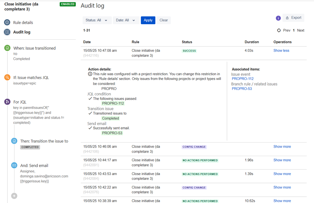

Sabina Tangaro
May 15, 2025
Hi Trudy, I've changed the branch as you suggested, but there is a missing condition, all epics must be in completed status. So my question is: is there a way to bind the initiative status transition when all its child epics are completed?
Following the new automation and related audit log:
BR Sabina

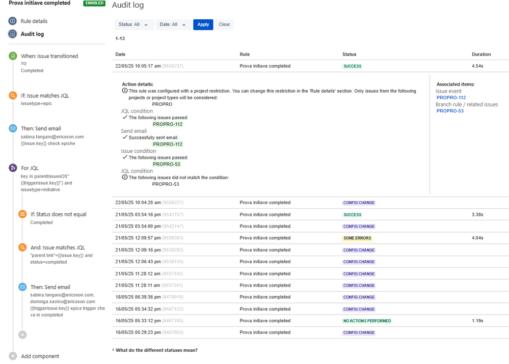

Dominga Savino
May 21, 2025
Hi Trudy, we have tried this automation but we have the reported error.Automation 1.png

Trudy P Claspill
May 22, 2025
Based on the last image you posted, this was the condition I was talking about.
Before this last change you made, it looked like this
With your update you changed {triggerIssue.customfield_11}} to {{issue.key}}. Revert that specific portion to what you had before the change.

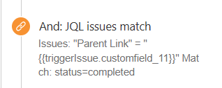

dominga_savino
May 22, 2025
I made this change, but something doesn't work (see message error 4 in picture "Automation 3" attached). It seems like the smart value {{triggerIssue.customfield_11}} does not return the expected result.

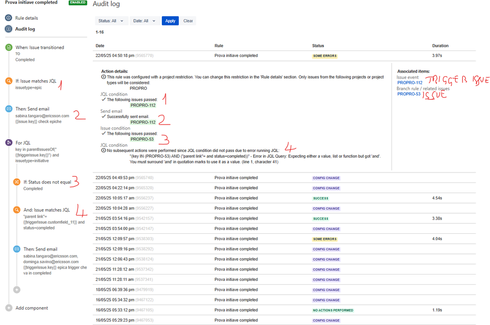

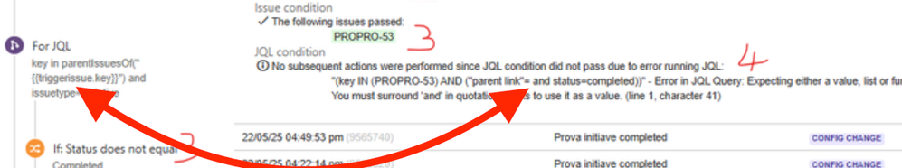

Anyway I don't understant the logic. If I look at the message error 4, it seems that if I use a condition inside the violet branch "For JWL" all the following conditions are linked with an AND operator (see error 4 related to the last condition).
In this scenario I don't see how I can extract the list of Epics child of a given Initiative if the JQL I use includes the condition Key= Parent Initiative Key.

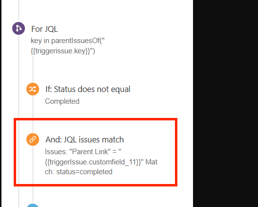

Trudy P Claspill
May 22, 2025
The rule is not getting any sort of value from {{triggerIssue.customfield_11}}, so there is no value being substituted into the JQL. You can see this in the error message. Notice that there is no value where the value from {{triggerIssue.customfield_11}} should be. So the JQL statement is invalid.
Where did you get the information that the Parent of the child issue is stored in the field referenced by "customfield_11"?
I assumed that you were intentionally obscuring the real custom field ID with that data.
If you don't have the correct field specified there, then the JQL will not work.
One way to find the correct field name is:
1. Make note of an Epic issue key where that Epic is the child of an Initiative.
2. Open a browser tab and plugin the following URL. Substitute the base URL for your instance and the issue key for the Epic.
https://baseURL/rest/api/2/issue/issueKey
That will output all the fields and their values for the specified Epic. Search through that output for the issue key of the Epic's parent Initiative. That will appear with the field name it is stored in near it.
